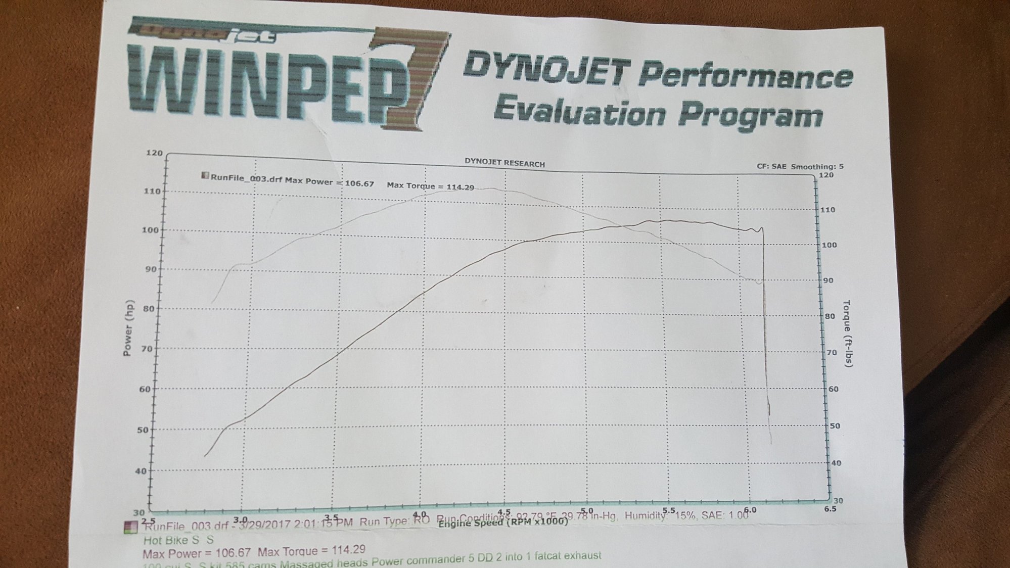

I have the S&S kit with ported heads (1.9/1.6), 55mm TB and it runs great.
