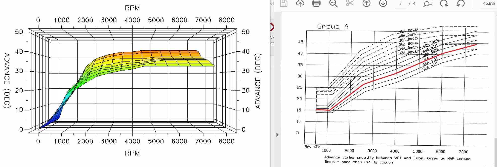

The thing to notice is that if you advance the timing so that throttle response is good, the WOT timing will be too far advanced in the upper RPM range and at partial throttle. .
Compare the timing maps. DTT on the right switches to the recommended 5/5 for stage 1 (could probably add a little) compared to a Dynatec. Notice that the Dynatec timing sags at WOT in the midrange then becomes way too far advanced as the RPMs climb.
I tried one didn't like the way it behaved so went to a DTT.
I lied..
I tried one didn't like the way it behaved so went to a Crane then a DTT. Both Crane and DTT were good but the DTT would allow for programmed maps.
