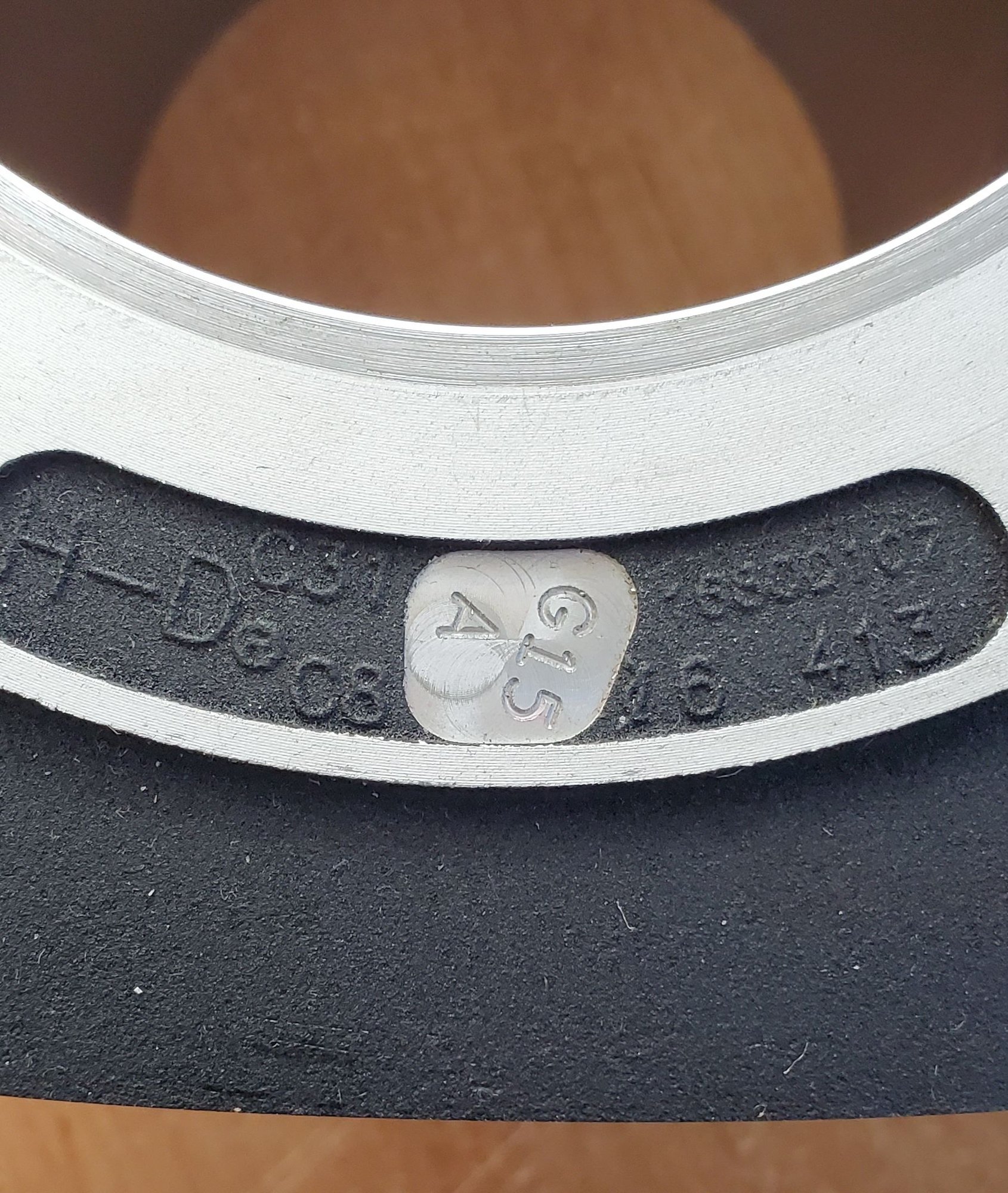

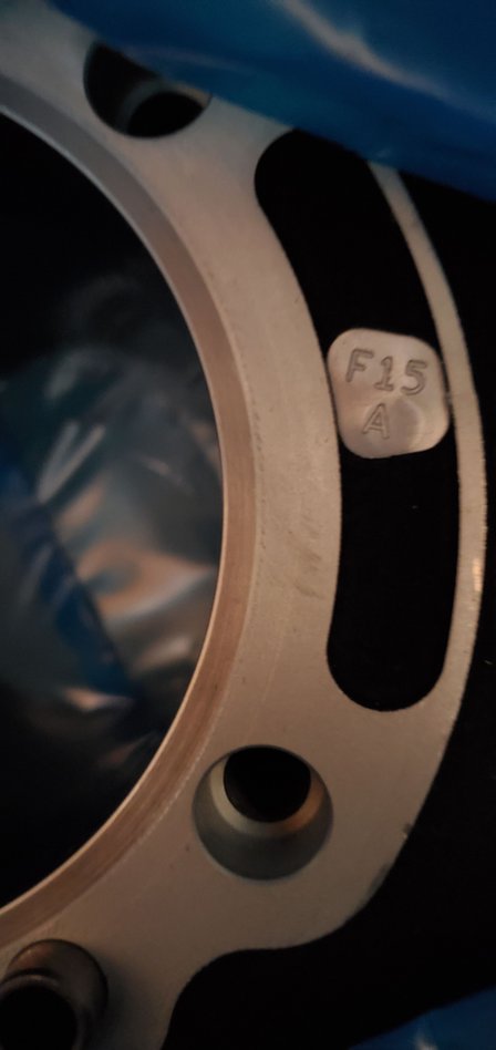

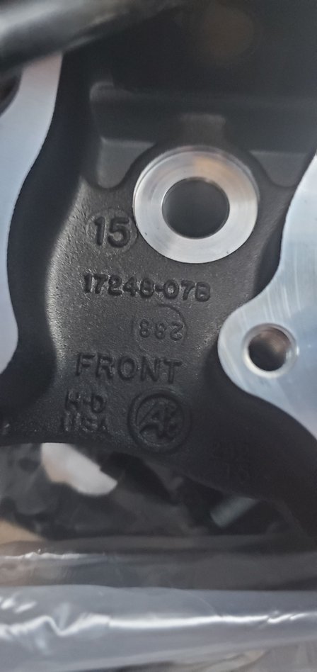

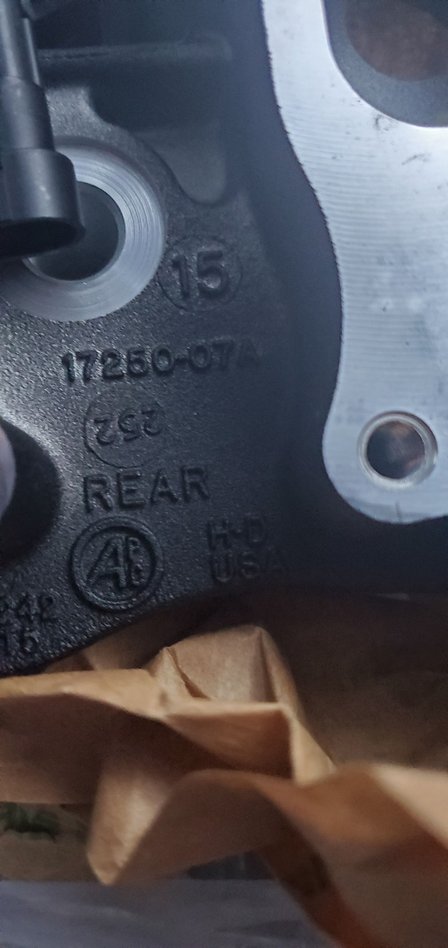

dji I took some pictures of the heads and they look like they were cast in 2015. Would they still be the recalled heads?
Also took some pictures of the cylinders numbers. You have any info on them.

I can only go by the PNs which are the PNs of the recalled heads. What you choose to do with them is your call.
