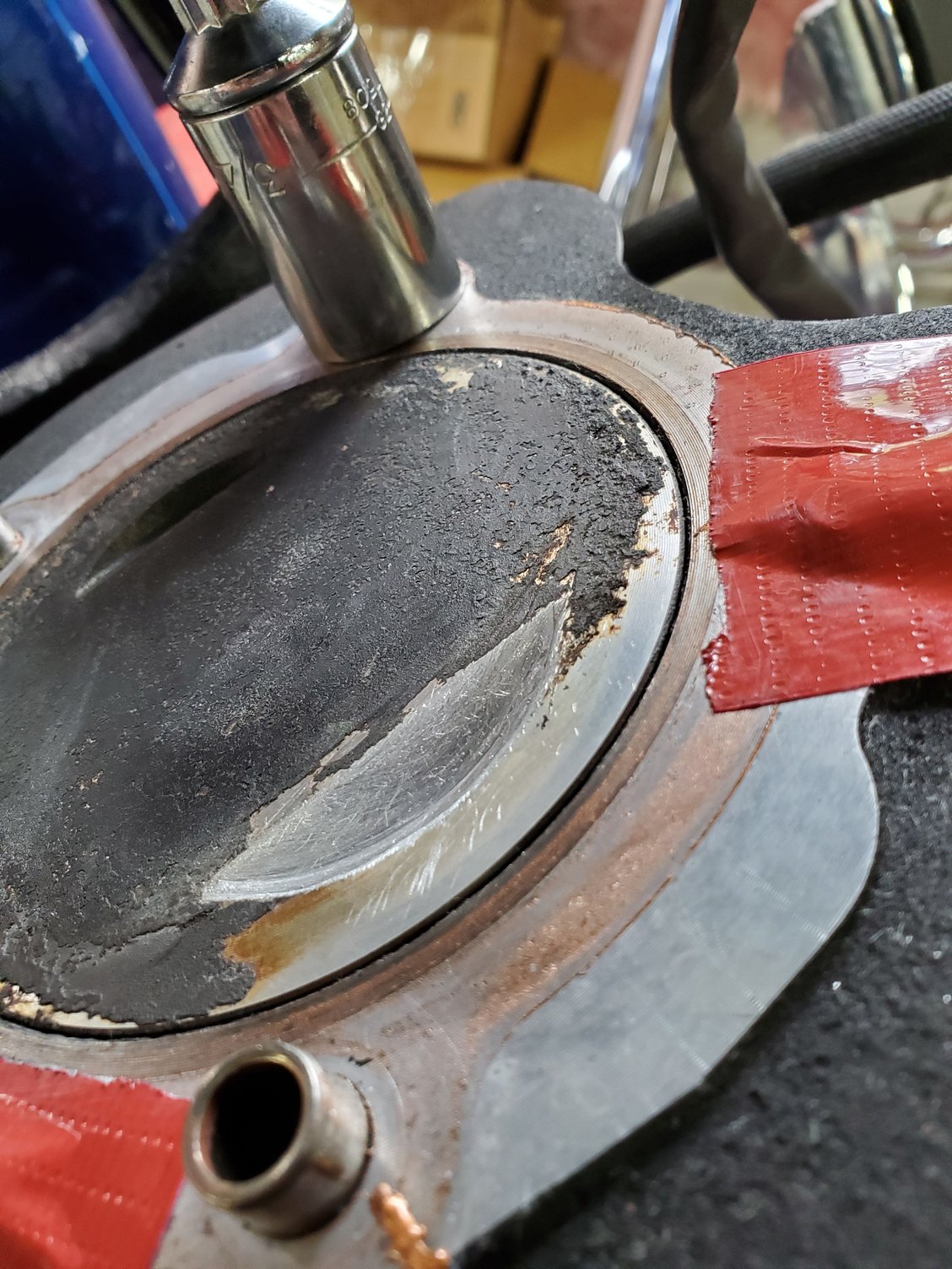

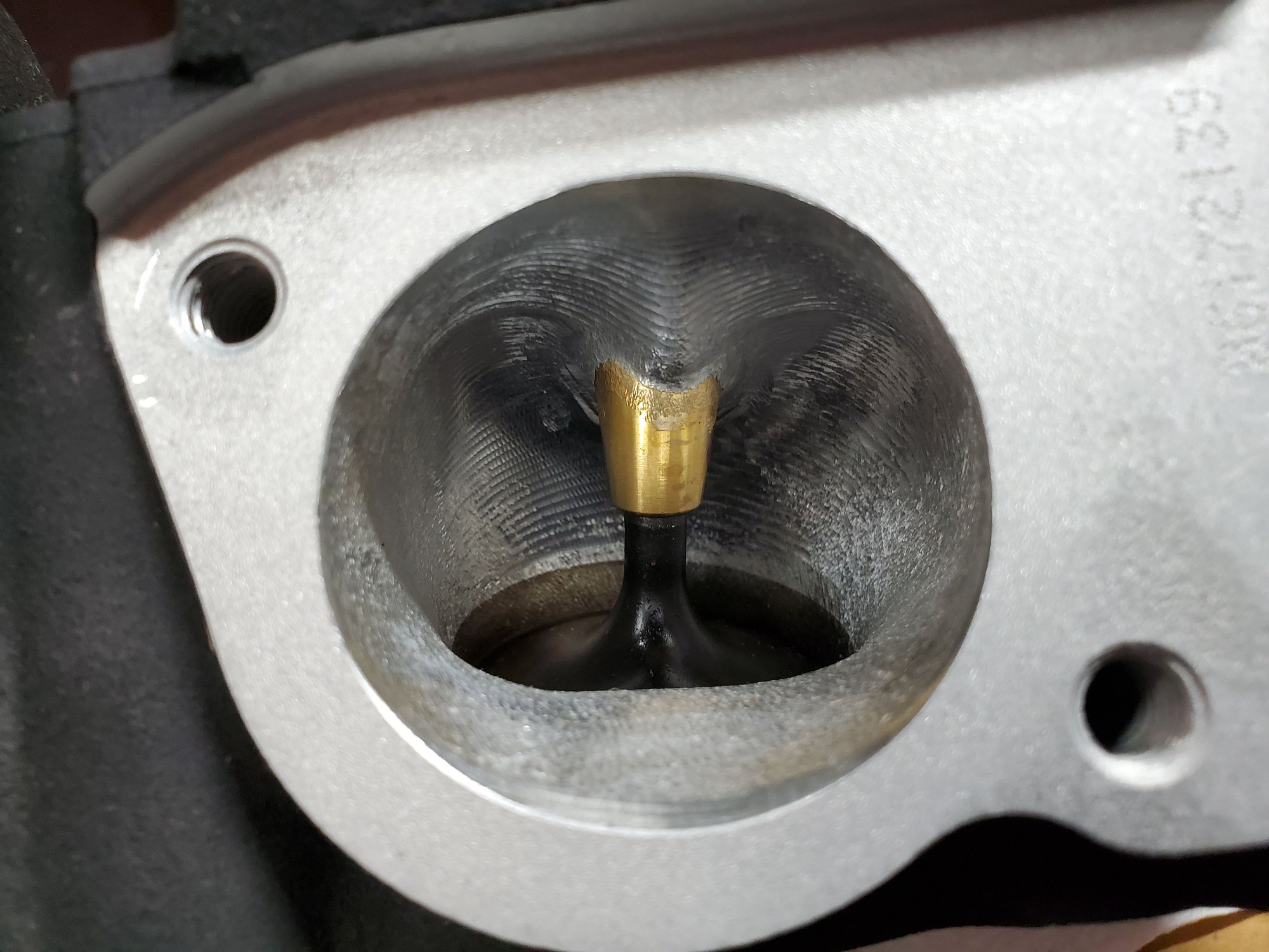

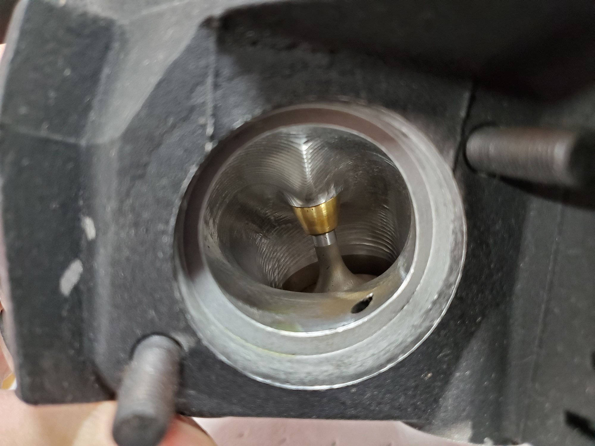

Never made it to a dyno to test just the cams, continued to run the map from FM. Got a wild hair up my rear and sent a spare set of heads to Don to get his "street pro cnc" setup. One of the heads had a crack around the intake valve guide area, he luckily had a core. Heads rolled out at just under 265cfm, similar to most guys "stage 2" heads. Target CCP is 200psi

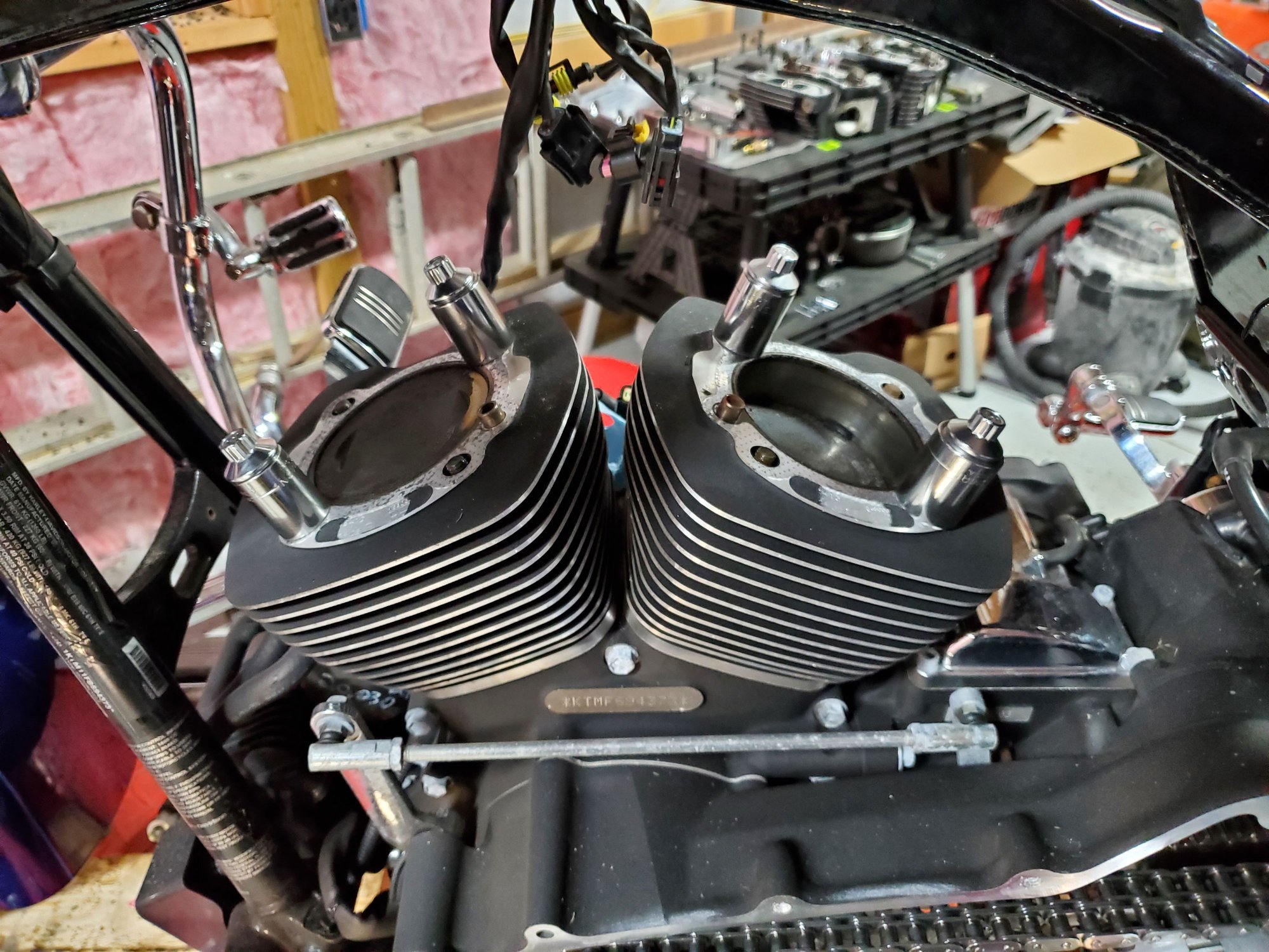

Got everything together last week, had to "modify" the intake valve relief to get more clearance, it was .038" with checker springs. In theory intake side can be pretty tight but I opened up the relief incase I changed cams down the road and they had a lot more TDC lift... FM sent a base map but I'll definitely get it tweaked in on the dyno, sometime.... Busy summer planned ahead.
