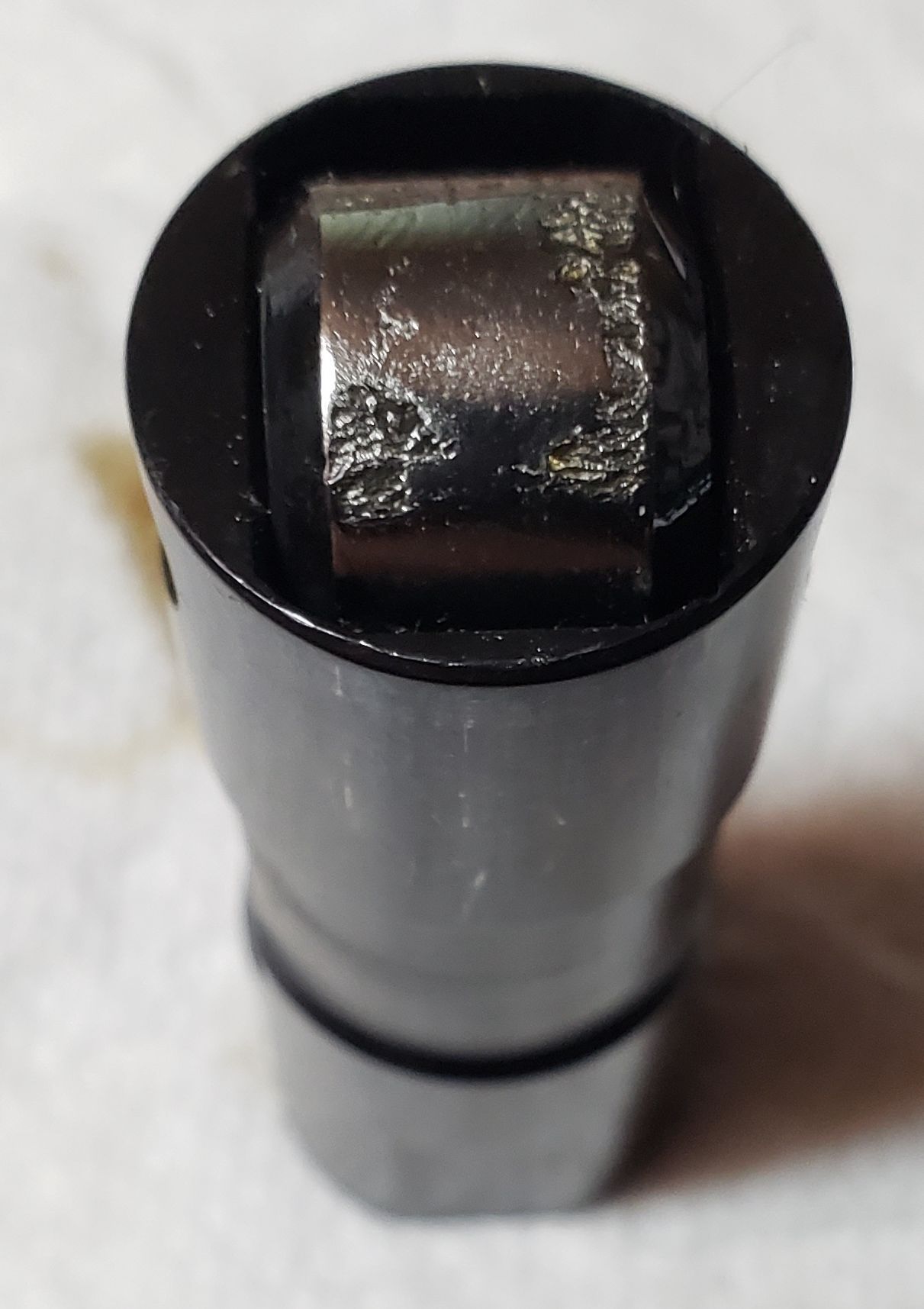

Had a similar noise coming from Reaper's engine, and it turned out to be a lifter roller. The surface was galled, and it had gone out of round!! Luckily for me, it still spun, and didn't destroy the cam lobe! Here are a couple of pics of what I found.
Cheers!
