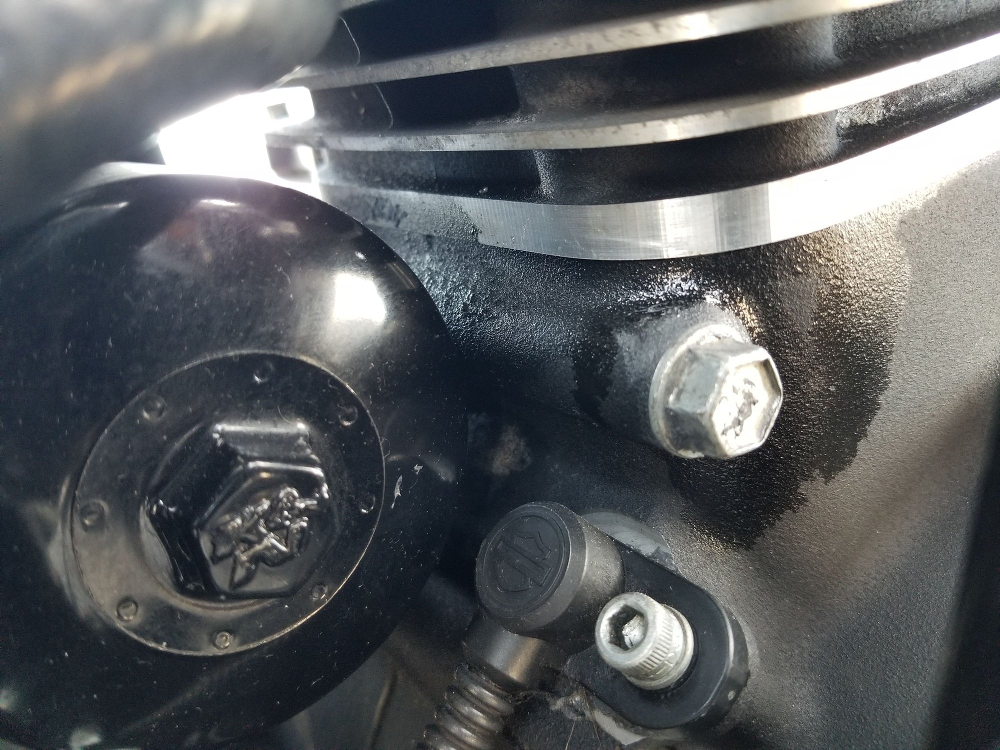

looks like base gaskets. what's the odds that both would start leaking at the same time. im
venting to catch can.

Most likely Buna cylinder base O rings. They'll get hard if the motor sees too much heat. Need to use Viton.

thanks Max. got a link to the correct ones.

Or the the oil return dowels are leaking since those are the 2 locations. I’ve found good results with the SnS oring dowel set up #500-0385

used permatex windshield sealant until I actually have to remove the jugs and it's been bone dry ever since.
