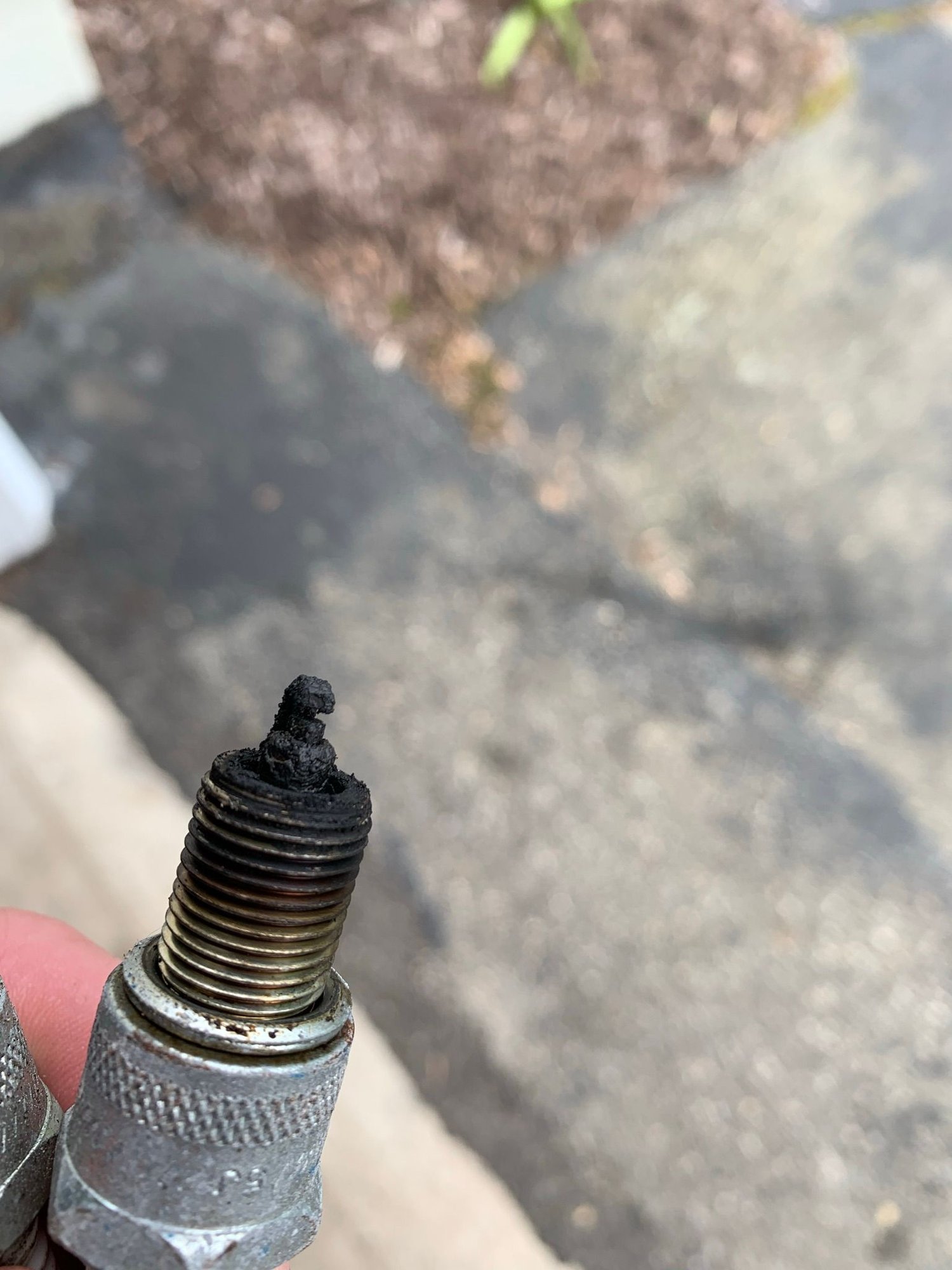

I’m new so take it easy on me… I inherited a 78FXE from my father when he passed. It ran in October of 2019 then sat in Florida until may of this year when I brought it to CT. I have rebuilt the SS carb, changed plugs/wires and tested for spark (it’s getting spark). He had upgraded to electronic points with a Crane Cams HI-4 so I adjusted the timing to the best of my ability having the TDC mark just coming into the window and adjusting the HI4. Gets gas(fresh) spark and air. Chased down wires and nothing is disconnected/broken. Also, when trying to start it, it just cranks, no sputter or anything like it is trying to start. Any ideas?

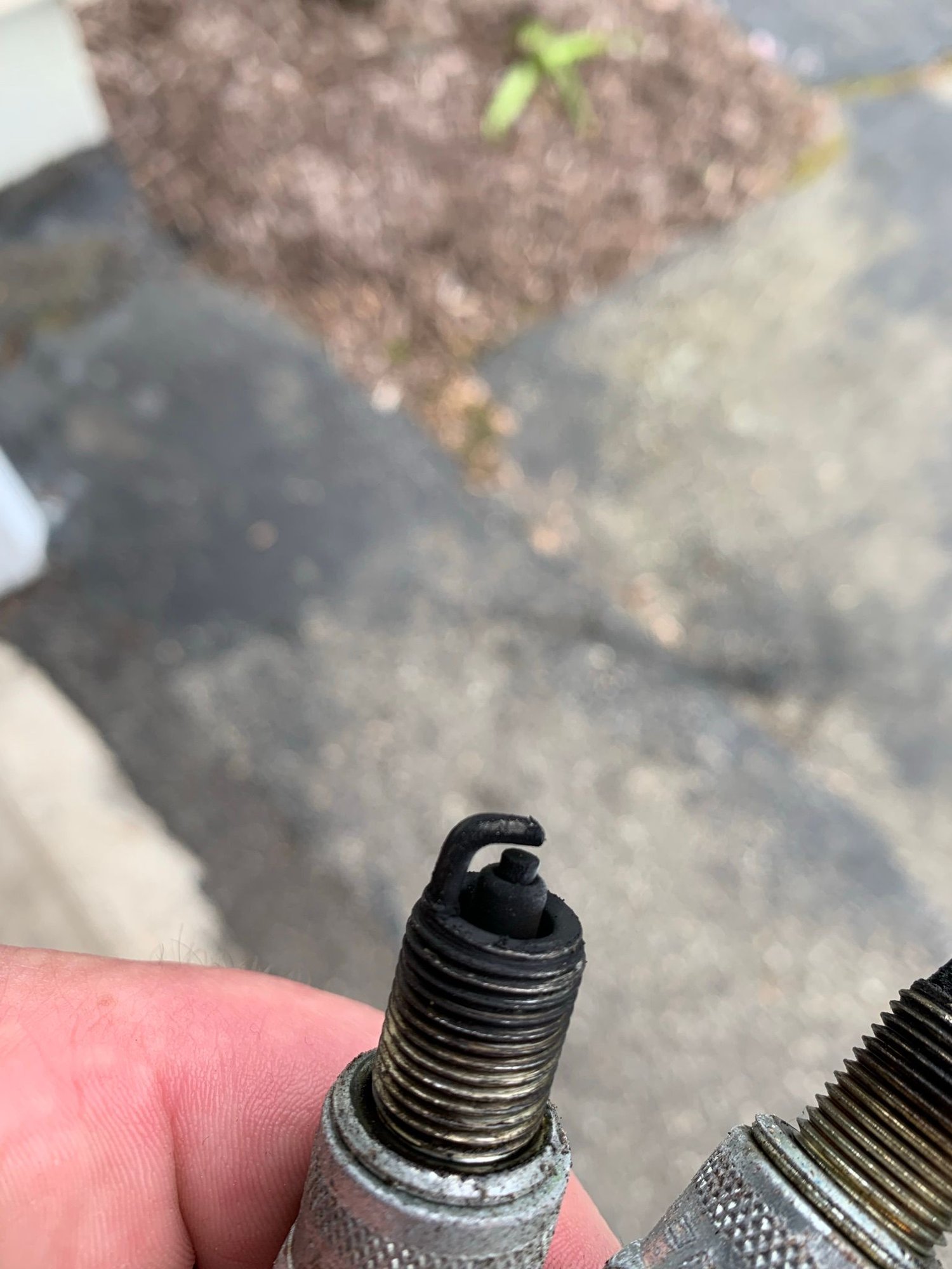

I will need to get a guage to check compression, carb is getting gas as I pulled the bowl plug to verify, as far as the wiring, I have changed none of it other than the plug wires, all other wiring is the same my father had it from when he was riding it. I feel like compression may be it since I have a thought the rings are bad, I will try to attach a photo of the old plugs I pulled giving me that conclusion.

if you are trying to get it started with THOSE plugs, that might be your issue, as they look like crap. did you try it with a new set, properly gapped?
