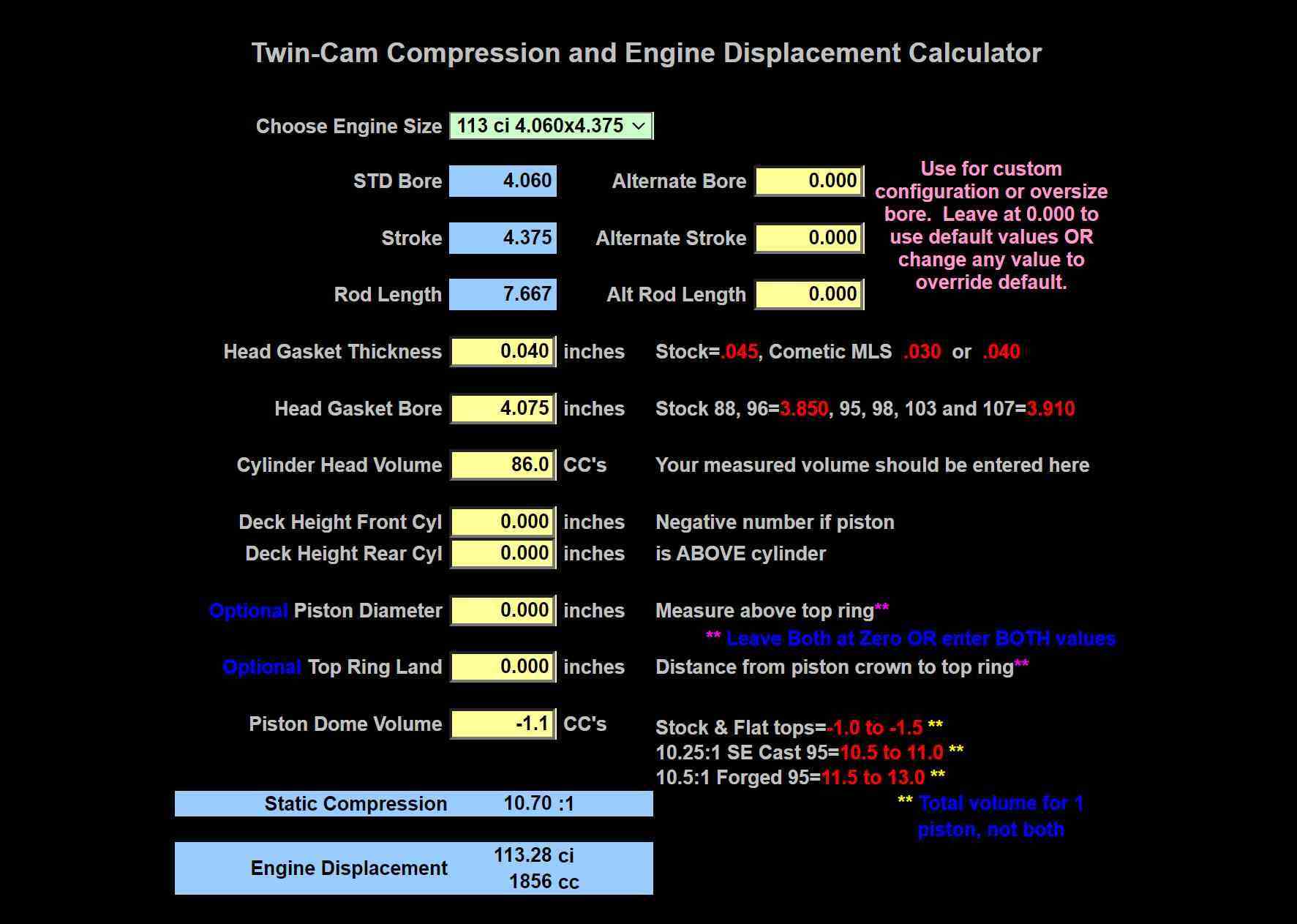

Personally I don't think this true. They simply make and assumption on heads used and many times they get it wrong. You could by SE CNC ported heads in 2015 that used stock heads with larger intake valves. They don't state the chamber size but imply they are close to stock. With those these numbers come out as advertised. See below.
I use alcohol too but not to CC heads..
Robin also missed the early SE heads that were 78-80 ccs.

BTW, If using the heads with bigger valves, check the valve pocket clearance. -1.1cc sounds like they are pretty small. and they may be cut for those SE CNC heads.
