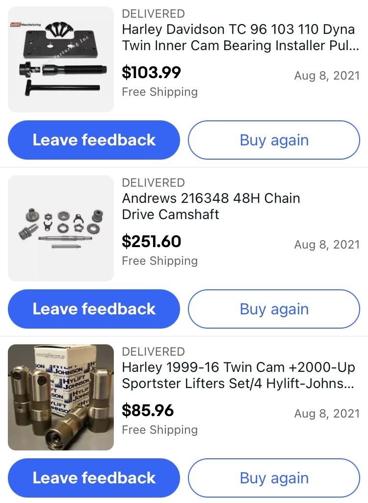

Throw those in the trash. Lots of options I choose these last fall for my Andrews 48 install.
