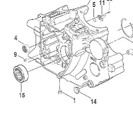

Is #1 in the attachment the plug you have tried to remove?
If the motor is sumping it won't suddenly lose power; it will be sluggish, like dragging an anchor and it will heat up faster as well. You have been in the cam chest and could have mis-aligned the oil pump or botched up the scavenge port o-ring, or both.
Softails gravity drain oil from the tank to the sump when left siffing for a few days so you will need to take a ride and get the motor up to operating temps to check for sumping. Have you done that? If not, the plug may be easier to remove at operating temps; it shouldn't be that hard to remove.
JMHO but you need to know if the motor is sumping or not before you get the bike on a dyno, cam change or not. A good dyno operator should be able to tell if the motor is sumping and will not proceed with the tune if the motor is sumping.
OK, will do.
Yes #1 is the drain plug I was attempting to remove. Well not be able to get to it for another few days. Will report back.
