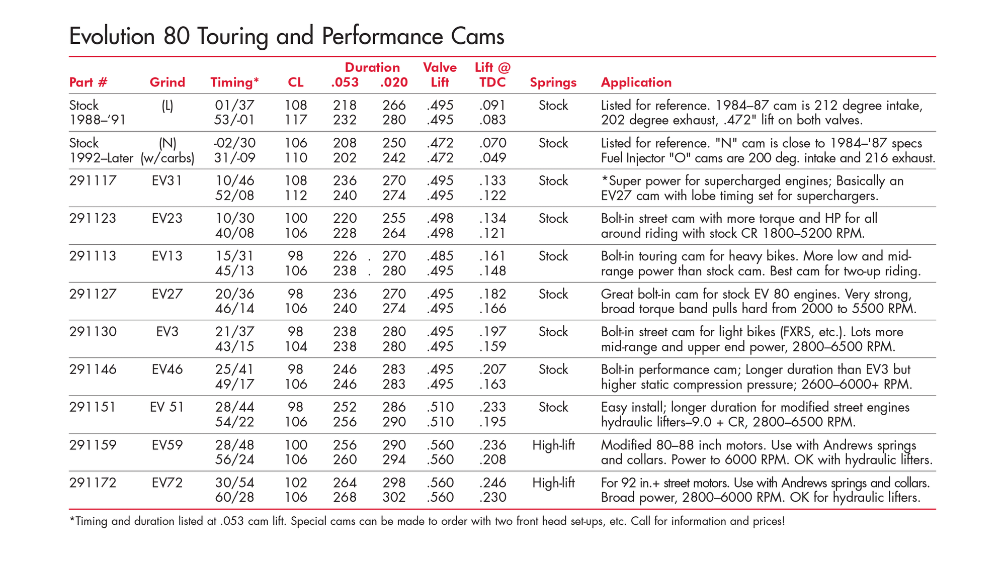

Okay, so I found this chart that details the Specs of various Cams for HD - funnily there is no open and close details for the EV13?
Despite the lack of opening and closing figures for the 13 - those figures for the EV27 look good to me and look as though they will suit my riding perfectly - open low and has a long (broad) power range.

Straight from the Andrews catalog. Ev13 is the smaller of those two.

Should have got the EV23
Thanks and I'll be darned if I could find anything. Anyway, will stay with the EV27 unless I buy the EV23. I don't ride two up so I think the 13 would be wasted on me when all is said and done.
