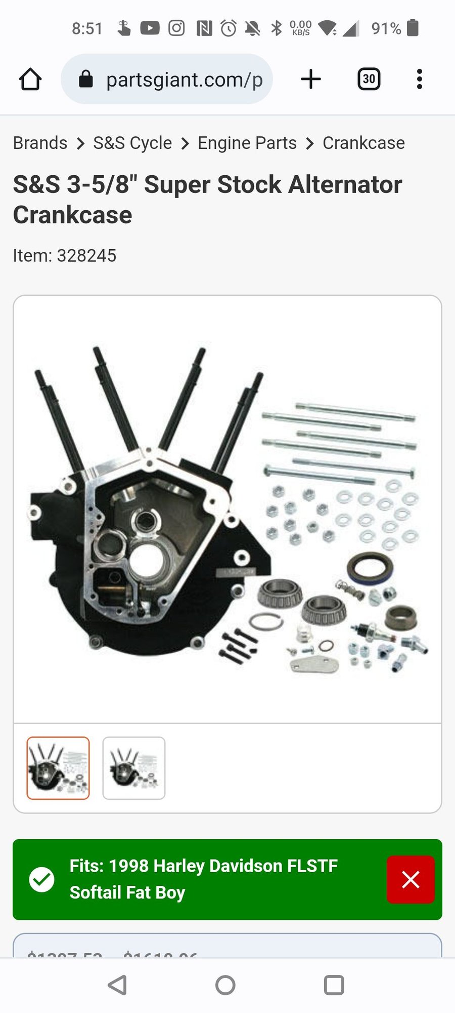

I am currently running an S&S case and crank@96". I would like to know what is the maximum size I can have the cases bored to? Looking at possible 116"... 4.0" x 4.625". If that's not possible what would be? The case in question is the one shown below.. Thanks..

I believe the biggest bore is about 3 11/16 inch.. The problem is that the studs are too close to the bore and there isn't any gasket surface left if you go bigger. SnS engine cases that support 4 inch and 4 1/8 bore have case deck raised 1/2 inch and different cylinder stud spacing..

The SnS cases are better but boring out bigger than 3 5/8 tends to be prone to leaks..

Yeah I'm not totally sure about the 3 5/8" cases.. I do know that S&S does make a different case for 4.0" bore and larger.. might be the way I go.. And then the pistons and cylinders..
The 4 inch / larger bore case has a 1/2 in taller deck and different cylinder stud pattern. Heads and cylinders are different.

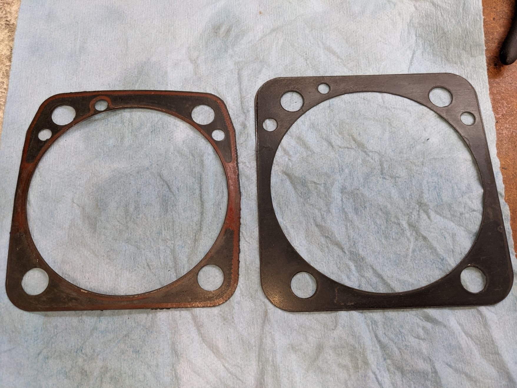

I don't think it's 1/2 inch but maybe about 1/8 to 1/4.. The crank would have to be different if much more. I do know that SnS TC cases have the tappet covers out about 1/8 inch. The Evo cases moved the Tappet blocks out a little.
Pic SnS EVO 88 ci base vs EVO 113 base gasket..
