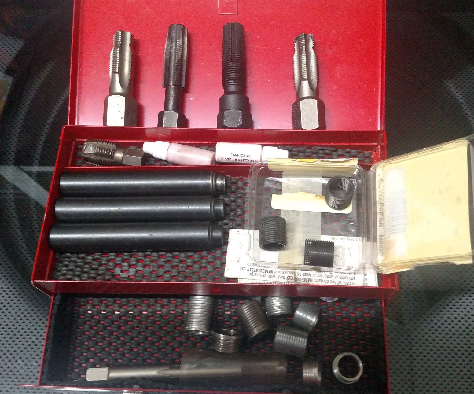

Find some of this stuff and soak it a day or two then try.
If you do end up stripping the threads if can be repaired without a tear down if you have a few tools and a steady hand. Done many a shovelhead this way. Any auto parts store or Amazon has the kits.
I'll look for that oil... give it a try. Thanks!
