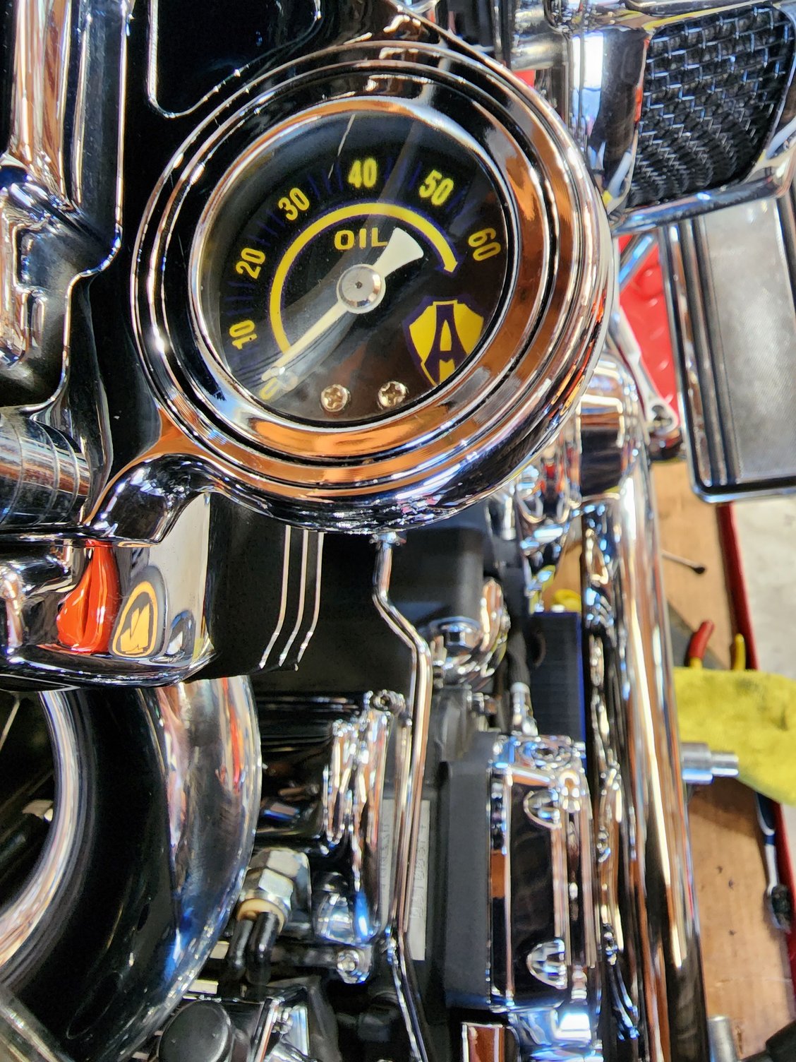

I have 2001 FLHR too. I believe it just brings the light on. I think it fails open. So loose like you saw will cause light to come one. Not positive. But easy enough to check. Unplug and see if light is on, plug back in.
I installed an arlen ness press gauge that goes from there to rocker cover. Bothered me at first toughing my thighg, but that was 18 years ago, and have not thought about it sense.
I have heard some say you don;t need a gauge just listen to bike, but I like it. Also like it for warming it up and taking easy until warm.

I also have the Arlen Ness oil gauge and it also burnt my leg. I fixed it by relocating the gauge to the front rocker cover. I had to use a Dremel to contour the mount a little so it fit. I only use it for diagnostic purposes.
I just ran a shorter oil line to the pressure switch since the standard line was too long. Still have my gauge and no burning my leg.

Looks like we all have that gauge, lol......

Sooooo.......... I have to add this note:
After a few years, maybe 4?, I noticed that the glycerin or silicone fluid in the gauge had started to seep out and get blown all over, making it a little tough to pinpoint where it was coming from. Started to make a mess out of the engine and stuff. Narrowed it down to the gauge and contacted Arlen Ness to see if they had a rebuild kit for it that I could install myself, or did I need to send it in for repair, or did I just need to buy a whole new one? I was pleasantly surprised when I got a reply back asking me for my home address so the guy could send me a whole new gauge to replace the leaky one for free!! AWESOME customer service! Especially nowadays when everyone is just out for a quick buck. (Read the thread about J&S Jacks!!!) Anyhow, swapped them out and all is good!

It's kinda easy to see if it leaked........ if it leaked, there's noooo silicone fluid in the gauge. If you see the bubble, you're good to go. If you look closely at the pick I posted earlier, there is no bubble, hence the email to AN.
