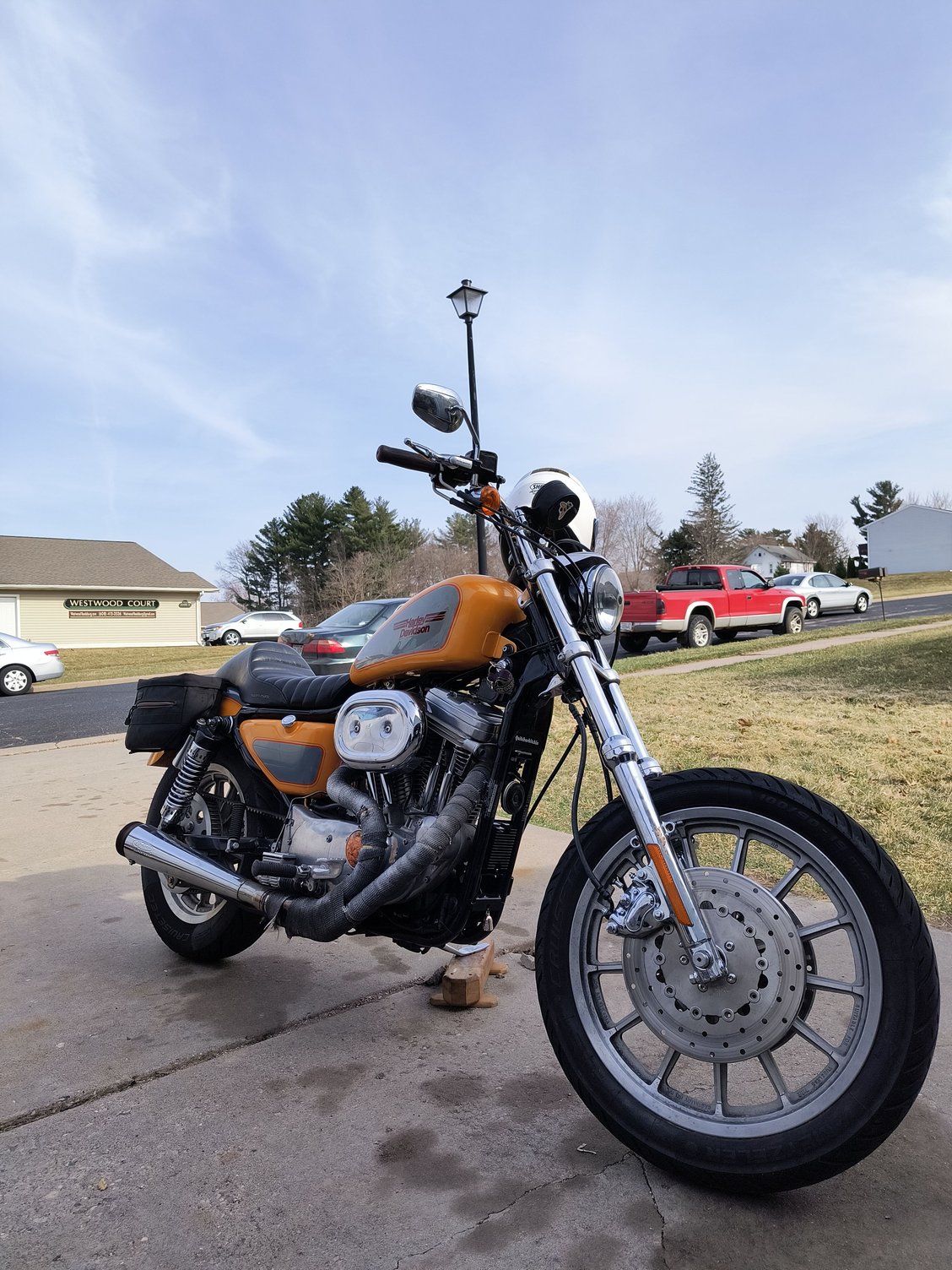

Just got it all put together, I reused the rings.
