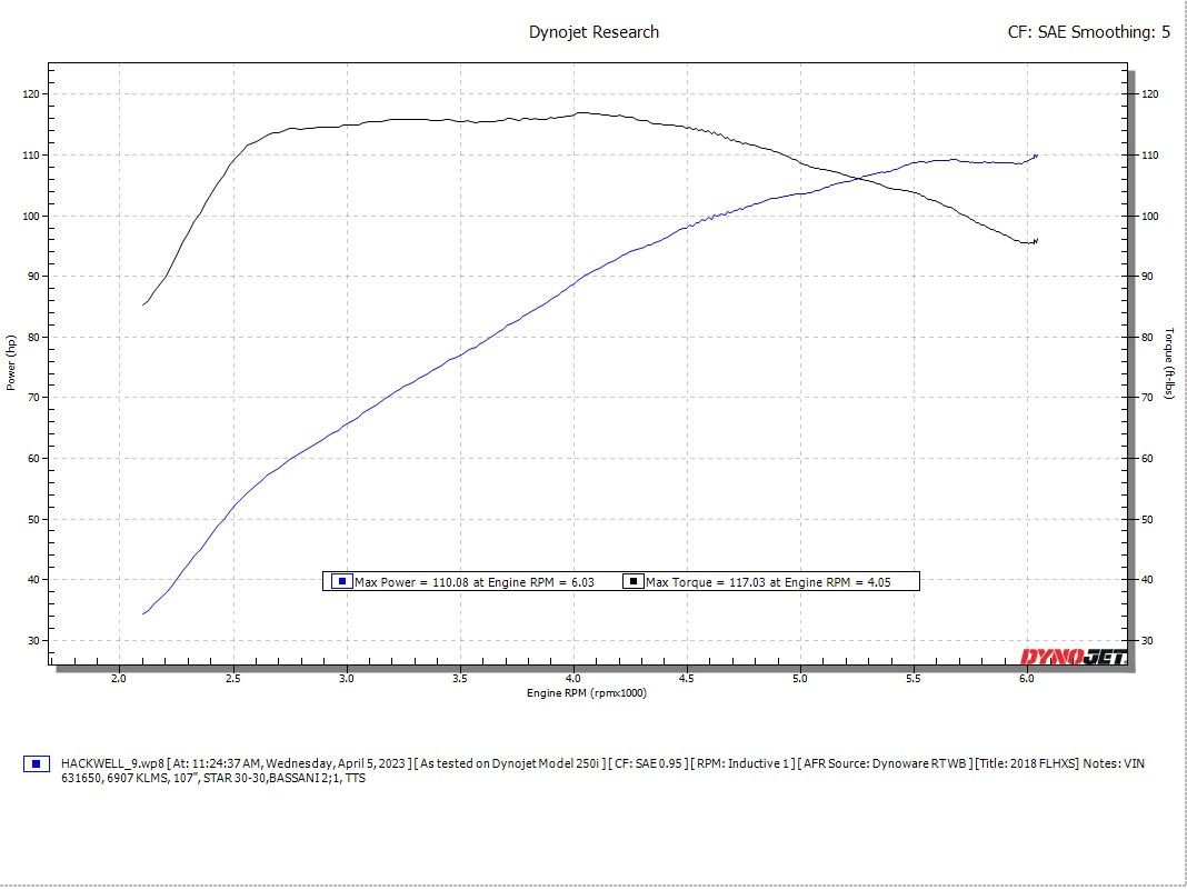

Probably because they don't know the answer. It's not the 22XE or 22XD.
What djl is getting at is it makes a difference what else has been done to the engine and where you want your power.
Depending on exhaust and such you could see over a 20hp gain and is a decent enough choice as a bolt in cam.
https://www.hdforums.com/forum/milwa...r-reviews.html
https://fb.watch/l9w8qsrouN/
