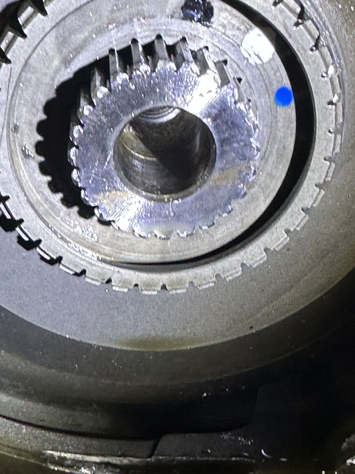

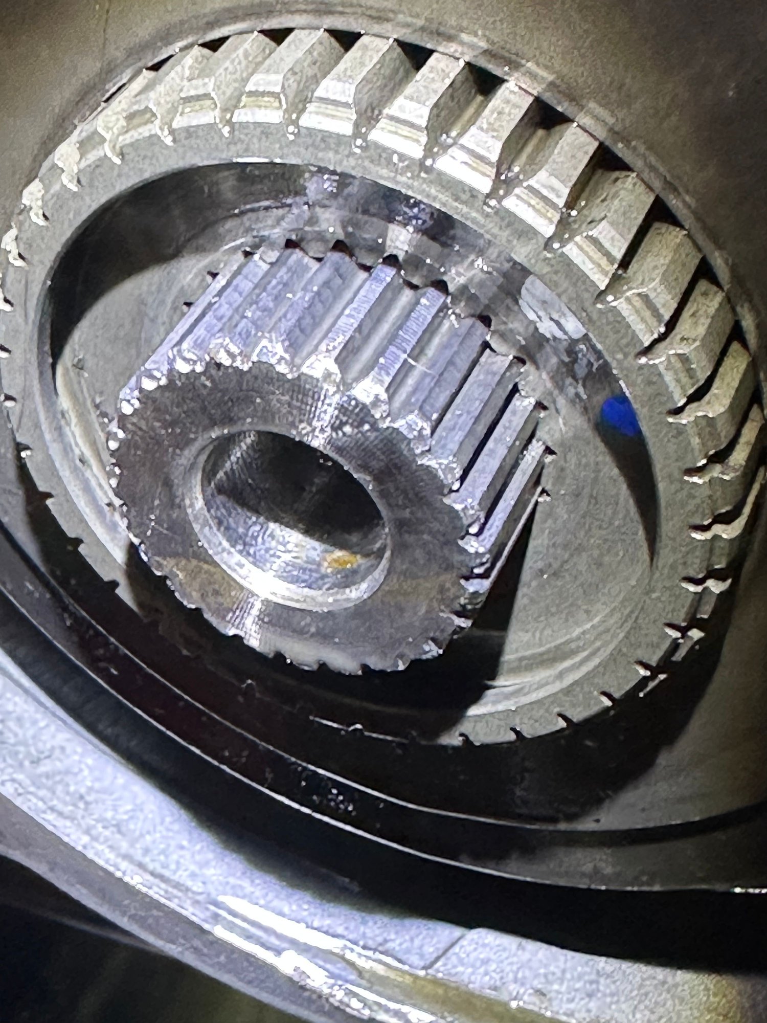

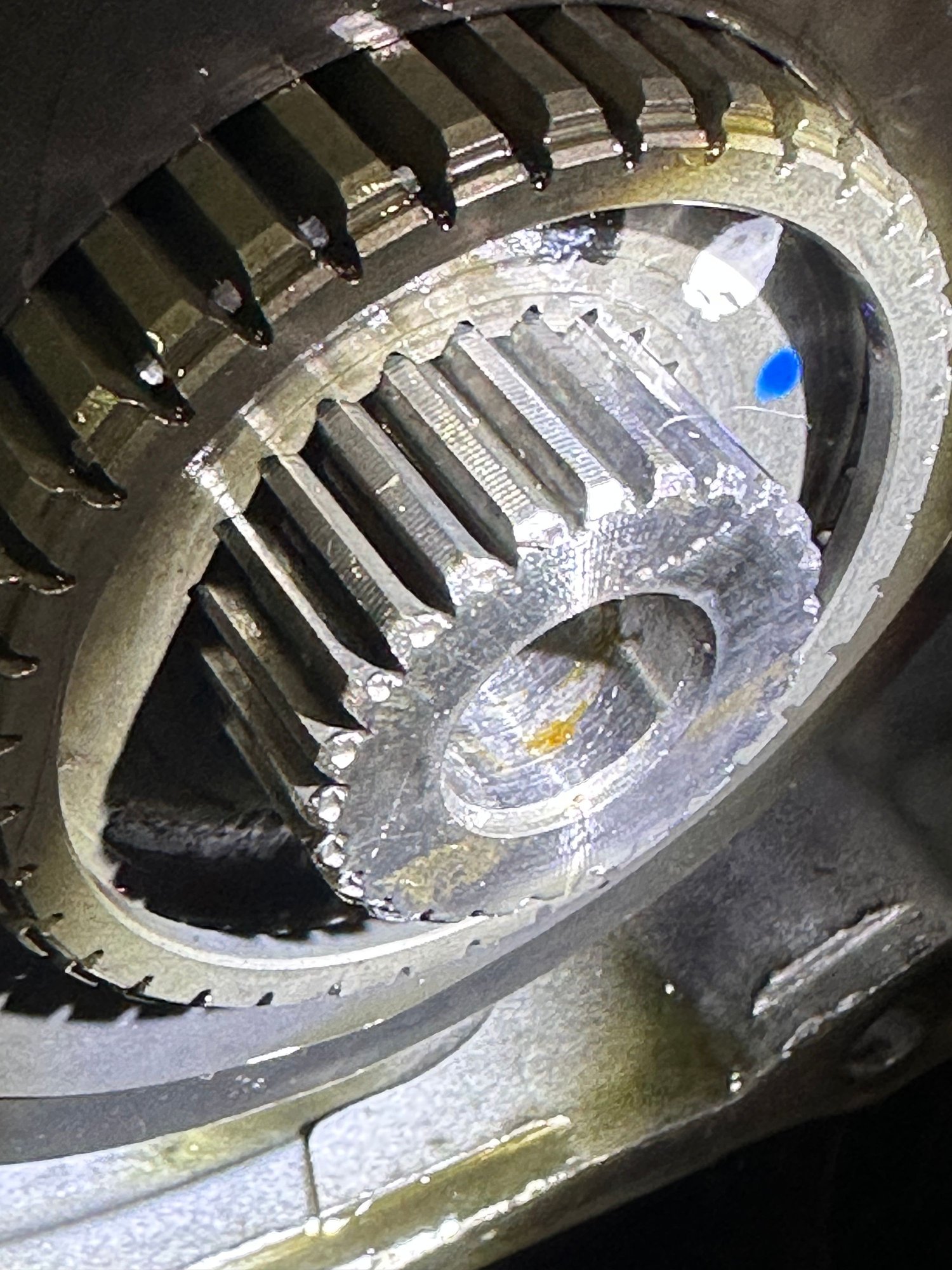

So after putting the engine back together, I noticed that the teeth from the crank where the compensator bolts up are chewed up. I can't fully get the retainer sprocket on since the teeth are binding.
From people I have spoken to, I hear either get a new crank or file the teeth to make it fit. I appreciate any other advice/insight I can provide to remedy this situation.

You have two choices, that is replace the crank which it doesn't look like you need to, or get a file or Dremel tool and clean up the teeth, What is the big deal?

This, just the entry ramp is buggered not the full spline. Diamond file or Dremel tool and a tapered carbide bit will clean that up nicely. Zero reason the think new crank for that .

Looks like someone tried removing the crank bolt buy holding the comp nut that the bolt goes through. It can be cleaned up with a file or grinder but you probably want to go to the latest comp as the nut includes the pulley sleeve with splines.

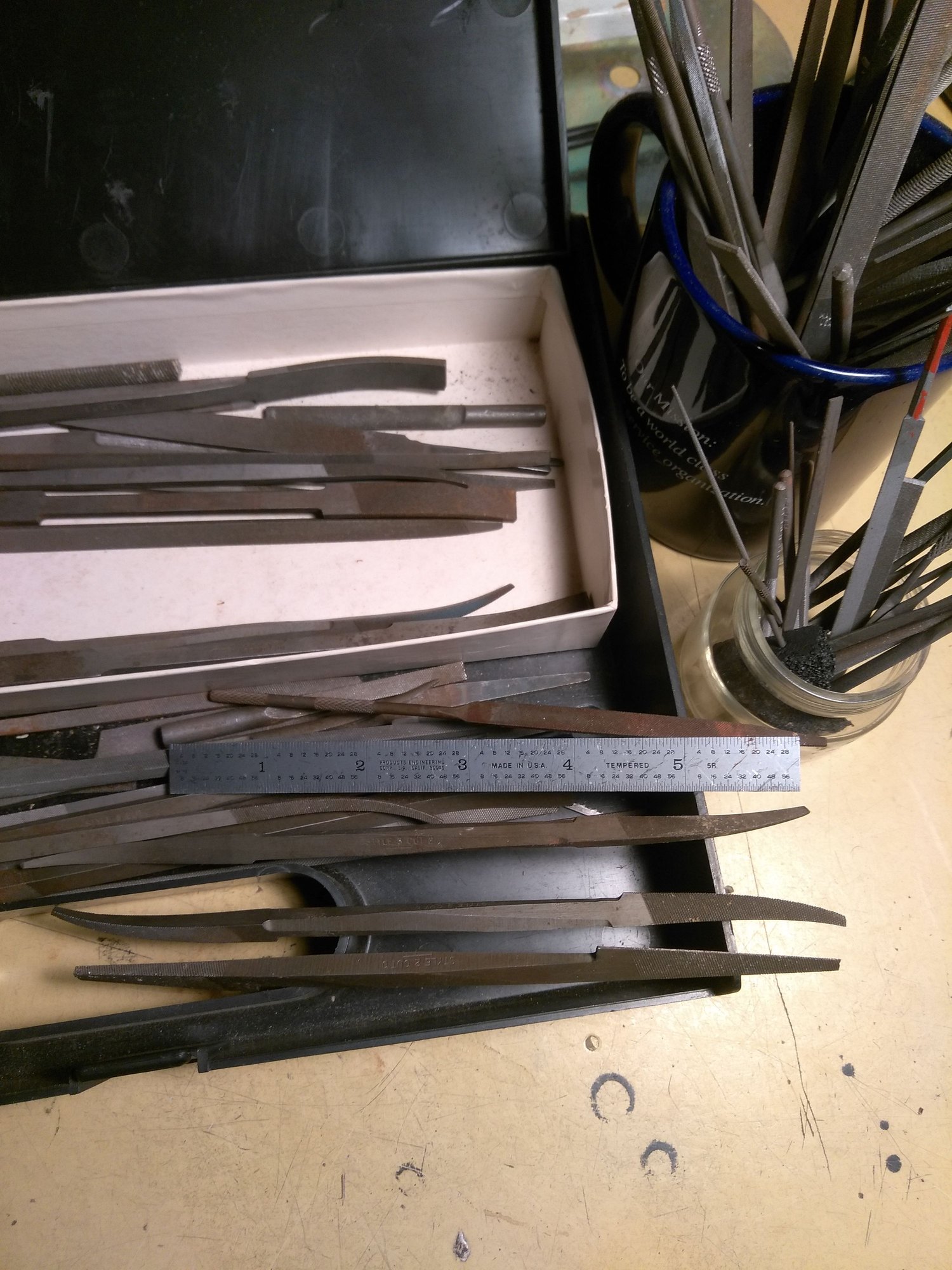

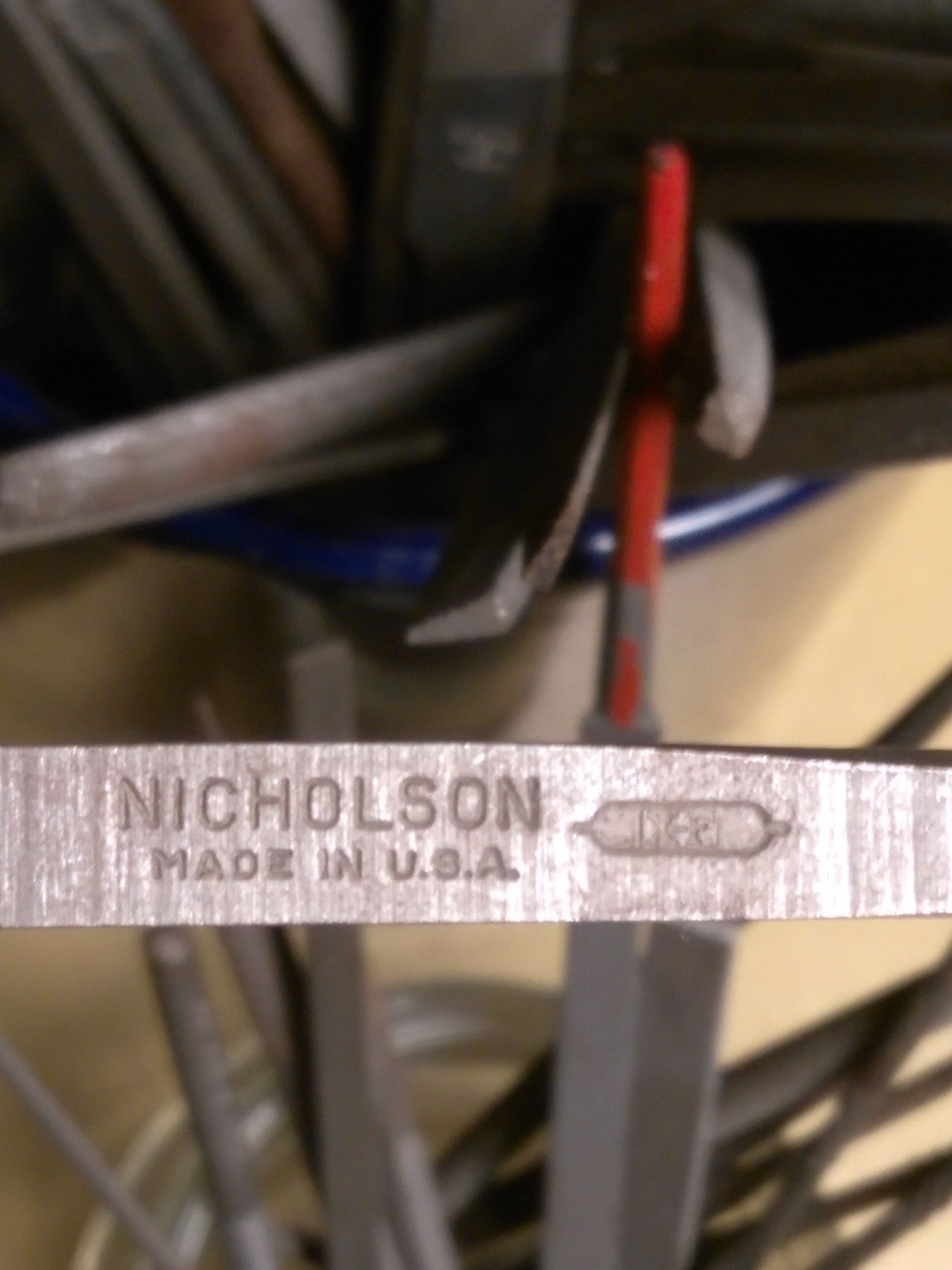

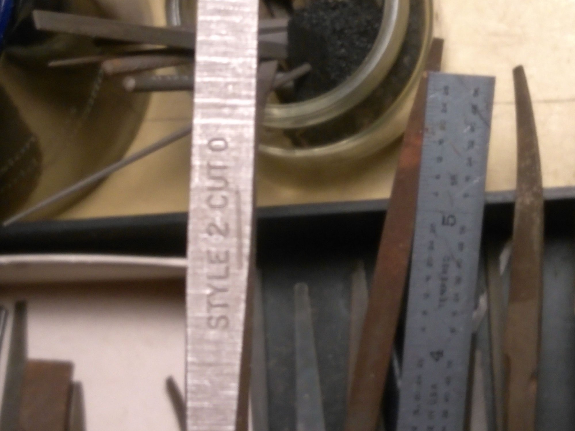

Pretty sure you are referring to the serrations. There soft. You need a fine cut 6" or so jeweler or toolmakers file.
Nicholson style 2 cut 0 is probably perfect but any knife blade shaped jeweler file will work.
That style 2 is in the second attachment in the blue cup showing end view and it's side.
