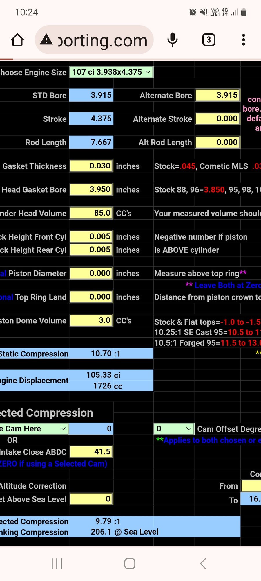

I've been reading a few of the top engine builders have been getting good results from the comp cams TC-3103.
they have been using compression ratio of 10.7 or so.
I'm doing a 96" - 106" build and wanting to use this cam, but can't see how to getting it to work at 10.7 compression...
This is what I get from big boyz calculator. Can't get ccp below 200?

Low 40s close makes my mind jump to ~10.5 static. If pistons are only 5 thou in the hole then quench is pretty ideal at .035”. Combine that with 93 pump I’d be ok with it unless it’s a touring bike (assuming it will be tuned right). APE has said good things about the Comp grinds, if they are one of the builders recommending that cam at 10.7 just remember they run different fuel out there. I like to push CCP but not everyone does so to each their own.

As a general comment, I am seeing a trend to run higher CCPs lately. I am running a CR595, 46*IVC in a 98" motor at 212psi with no issues, even in south Texas summer heat of 100+ with no issues. I believe if the motor is tuned by a real "tuner", higher CCPs are possible.

Providing a good tune and access to decent fuel, I wouldn't run a CCP less than 200psi.
I'm running 212 myself. 11.0:1 CR with the Tman 590 and 43° IVC.
No.issues with detonation on the hottest of days..

Yeah, I would have thought 10.5 static is the maximum, but APE and some of the very reputable builders in the US are having good results at 10.7.... just wondered if it can be pushed that high?
Seems like it would work if tuned properly.

If you're that worried about it then why are you running a 3cc domed piston with a cam that has a 41° IVC? Run a flat top and 84cc heads.

not worried about it, just looking for confirmation that is OK to have that much compression

Assuming decent fuel is availale, it will depend on the quality of the tune. I 10.5? 10.7? static is just a number; CCP is the guide for me.

Yeah, I agreed that dynamic compression / ccp is more important.
With 10.7 static and the TC-3130 I end up with over 206ccp and 9.8 corrected compression agriculture
which I always thought was too high, even with a good tune?
