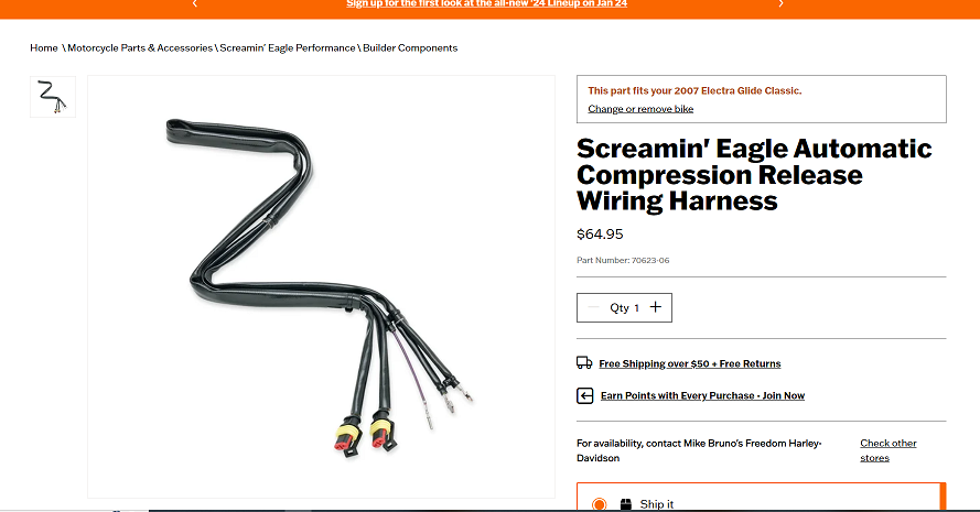

The EZ start issue I heard of was if you put them in bike with ACR's,-- too low compression to start, just had to deactivate them in the tune.
Some make noise at idle or you hear them clank on shutdown.
Something else is pushrod adjustment is a little different on EZ starts, is it possible to do compression test?, run it on one cylinder?
Another option is to get later 103 heads with ACR's and install HD's SE ACR harness, that's what I did with my '09, well worth it for me, those manual CR's soon become a pain.

Not doing S&S EX start. Doing .040 head gasket which will lower it a little. Doing S&S MR103 cams, but not the easy start. I agree manual releases would be a pain. Though now would be the time to install, but hoping I won't need to .
Why would someone do EZ starts with ACRs?

Not as much of a pain if you need them. may or may not, you should still be around 195ish on compression psi.
