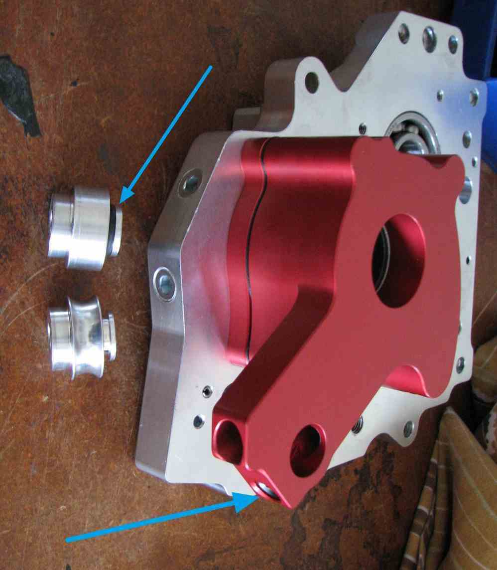

Well either your oil pump ain't scavenging correctly or some how you are pushing too much oil into the crankcase.
I'll assume when you pulled the cam cover the camcase probably had less than a cup of oil in it..
I guess it's possible that there is something wrong with the pump. Maybe a passage not machined or plugged? You used a Fueling pump and cam plate?
Here is a pic of a Fueling pump. Maybe the passage plug was not installed?
This a pump for early TCs but it has a connecting spigot that needs O rings on both ends.. If one is missing you got problems..

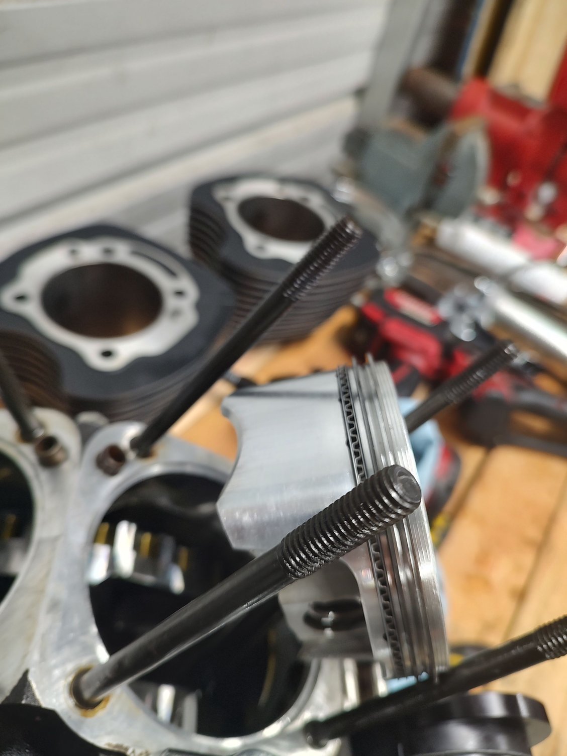

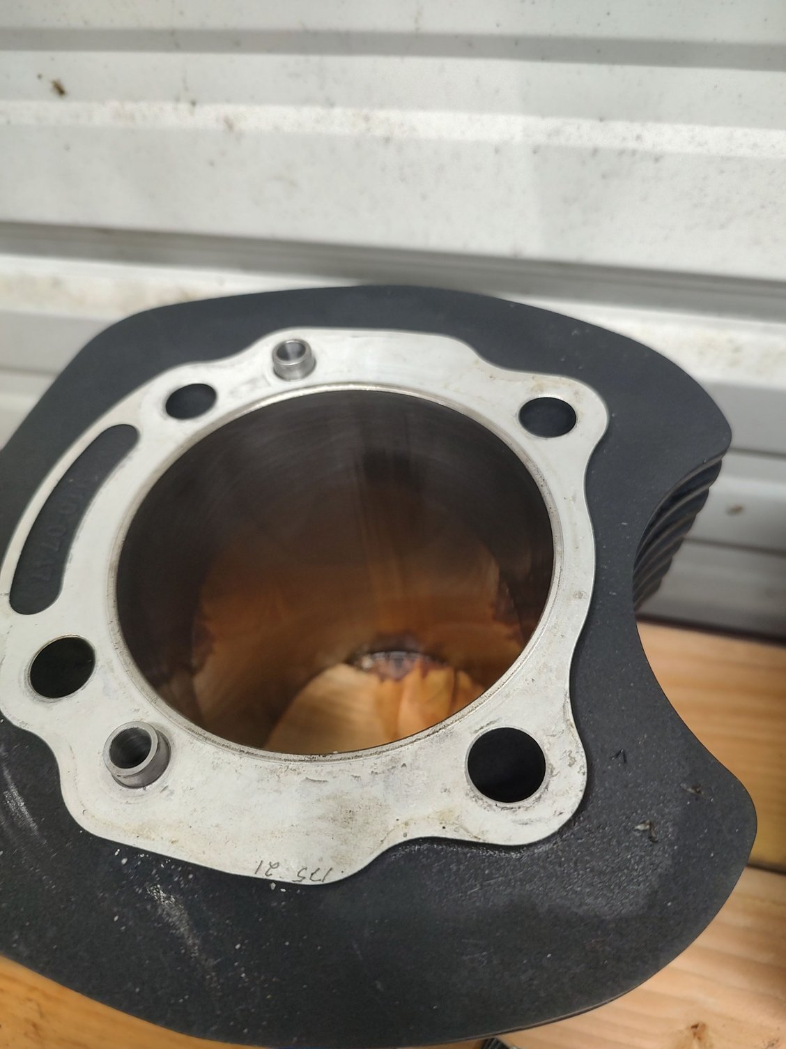

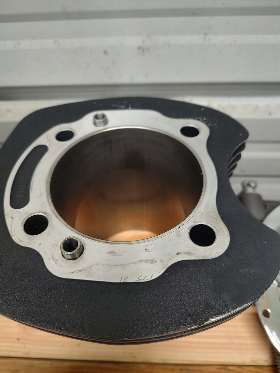

So, after checking out the cam chest and being sure nothing was out of place there I pulled the engine and started breaking her down. Everything looked good. I removed the jug carefully, but not painfully slowly. Rings were noticably out of alignment though they were oriented top side correctly and roughly 180° opposite to each other. How much displacement can be figured for when the pressure from the jug releases the ring? Enough to change position 30° or so?
Also noted the jugs wear pattern, see photo. It's distinct, what does it tell me?
In rebuilding, can these rings be reused? Anything need done to the jugs, or simply get new gaskets and seals and start rebuilding?

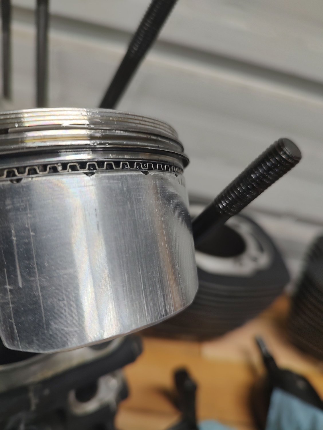

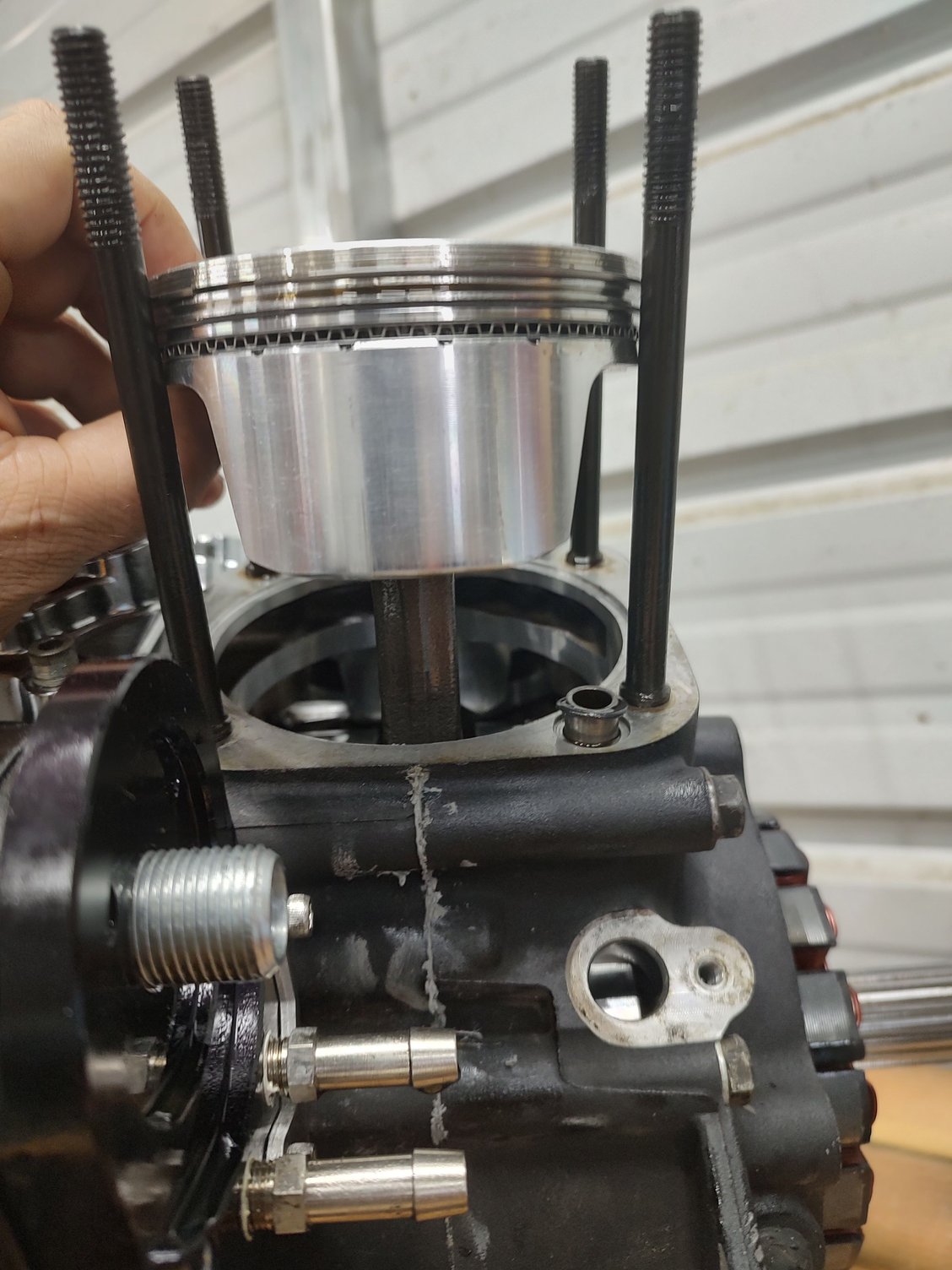

What do the piston skirts look like? Can you post a picture of them?
Forest face, forward jug
Forward face, forward jug
Rear face forward jug

the front 2nd ring groove looks questionable

pistons real clean for all that burning oil.
