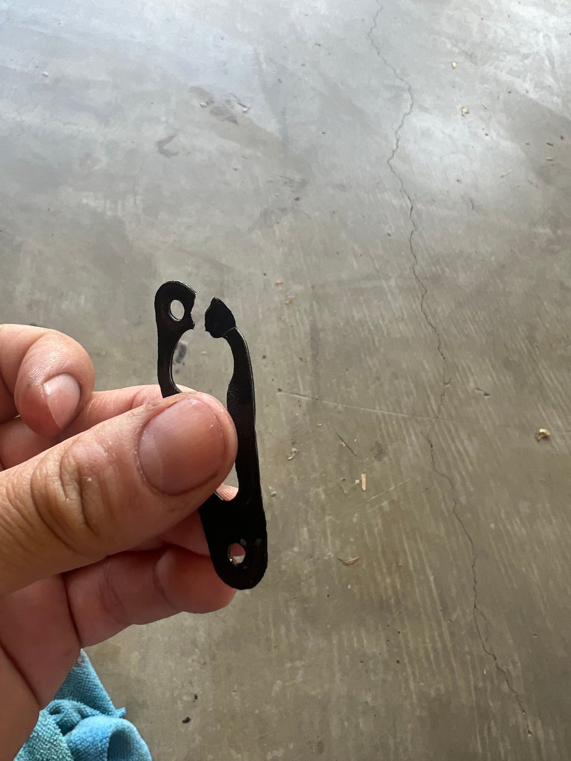

I pulled my oil pump. Checked it, didn’t find any issues. Decided to pull my cylinders due to my sumping issue. After I got the cylinders removed, not really seeing anything along the way. Visually checked the piston oil jets, had installed the S&S oil jets during the BB install. Right away I noticed the gasket hanging out from the bottom. Installation error. I missed one hole completely while installing. It’s a tight space and had a bunch of rags in the case. Was worried about dropping something in there. Stupid mistake. But happy I got it figured out. Put everything back together and doesn’t seem to be sumping at the moment, oil returns to the tank. Even in the instructions for the oilers it talks about gasket alignment.

When you split the cases, pay attention to the oiler gasket surfaces, when the factory installs the self tapping screws, it pulls the metal up around the screw holes.
Use a new razor to scrape the gasket surface for the oilers flat, first work on just the raised areas around the holes until the lips are gone, then across the surface.
