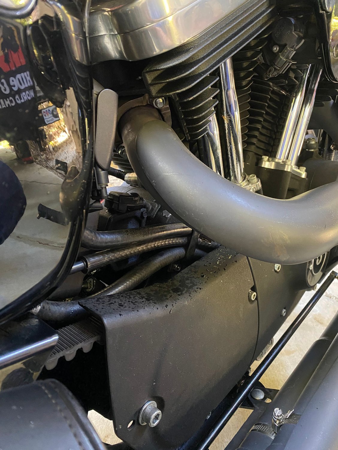

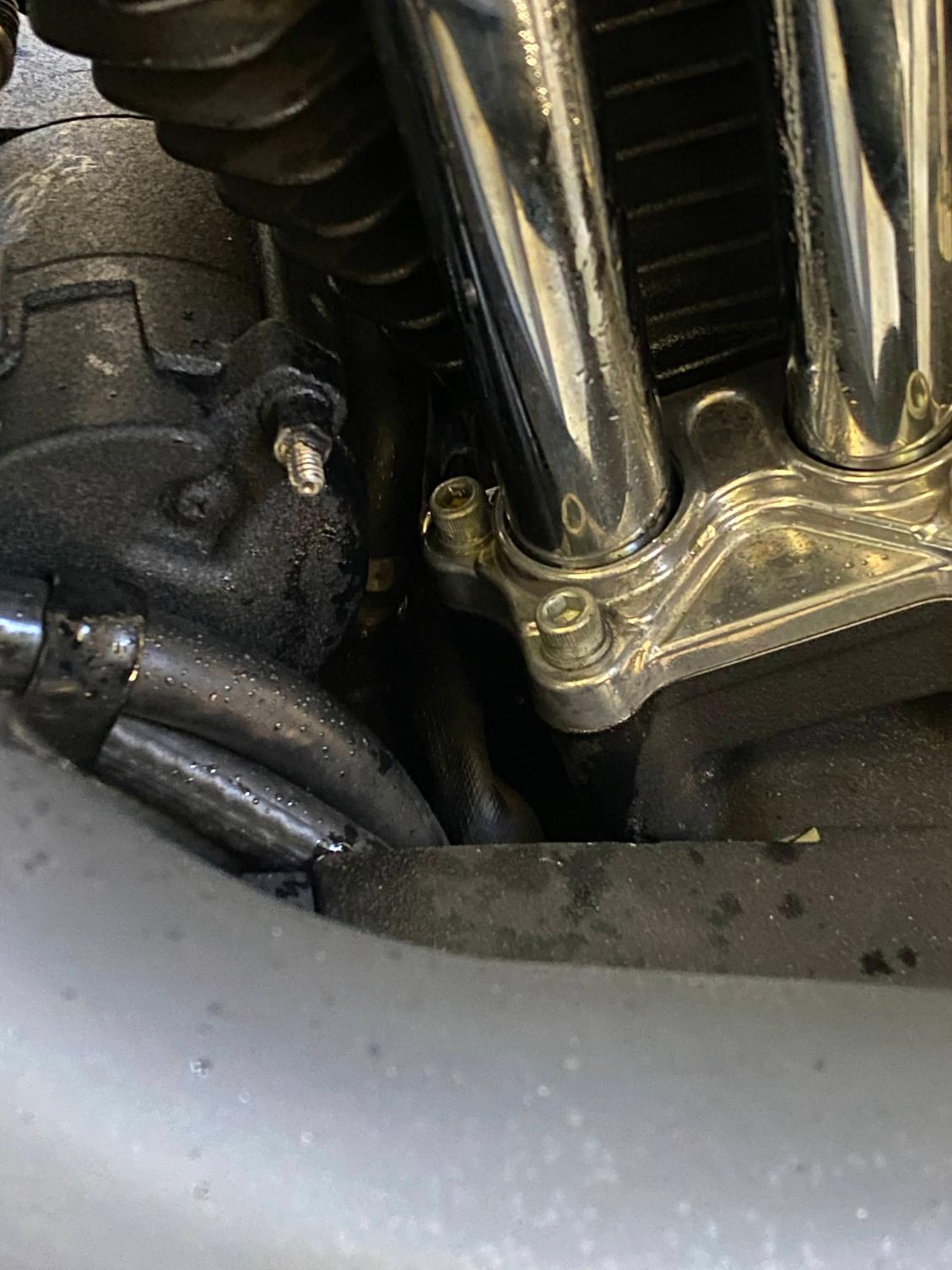

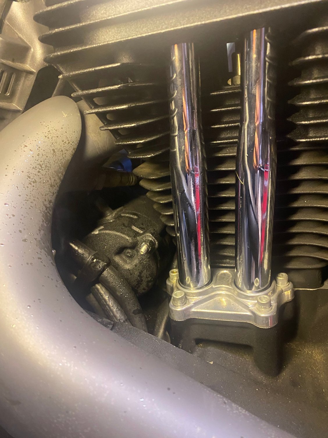

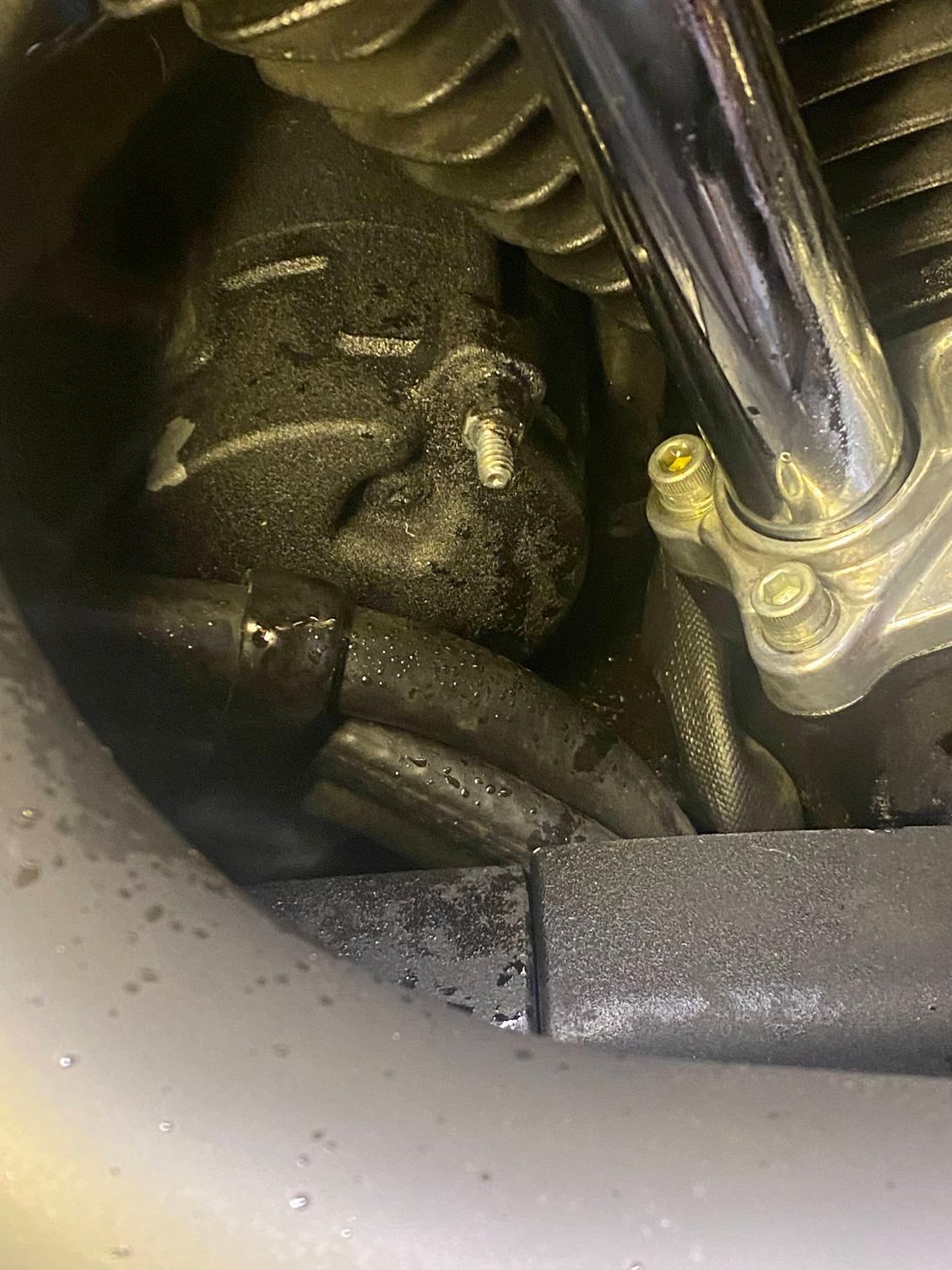

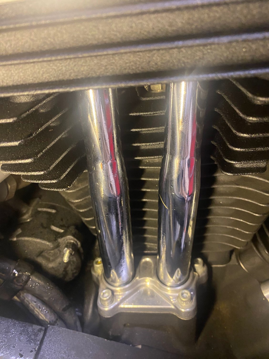

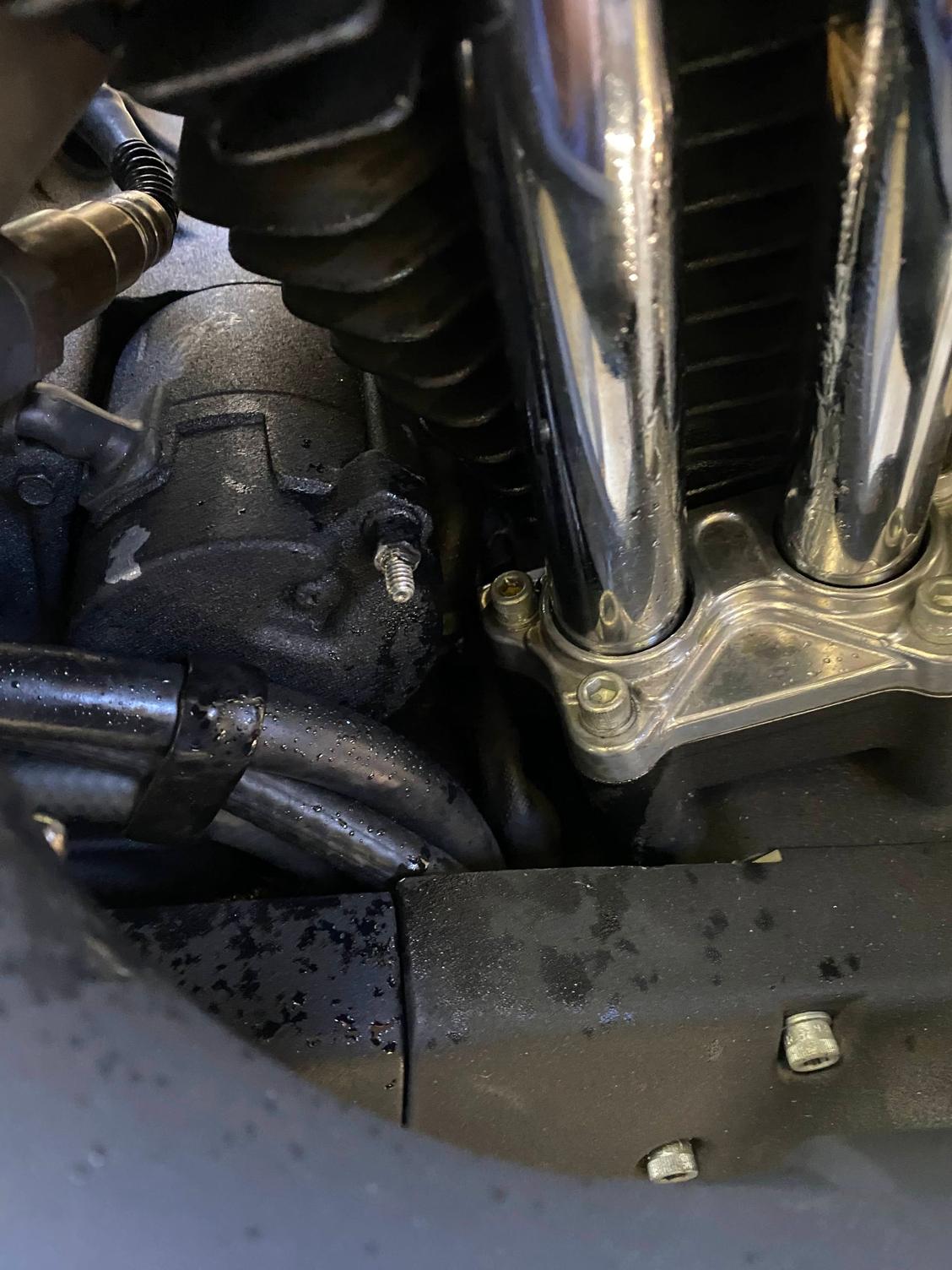

Hi folks, I'm new to HD and this is a new to me 2013 XL1200X, had some issue with TSM which I finally resolved and took it for a first ride after many things were done to it at a couple of dealerships including replacing the jugs and the heads and the bike probably never run since.
After a 2 mile ride I came back home and realized there was a pretty big oil leak spraying oil on the drive belt cover, exhaust, right behind the rear cylinder and my right leg as well.
When looking at the engine running I can see tiny specs of oil flying around but can't see from where, I suspect it's coming from the pushrod cover, most likely the rear pushrod cover as it is the wettest.
The air filter is dry, as well as around the air filter mounting plate.
Does it sound about right?
My other suspicion is a rubber tube coming out of the case right behind the rear cylinder, it looks fine but the oil ends up pooling up in that area.
I'm somewhat handy and can probably replace the o ring on the pushrod covers myself, it doesn't look too complicated, but if that's the culprit, it was done by the dealership. Is it worth fighting with them? Or just do it myself?
