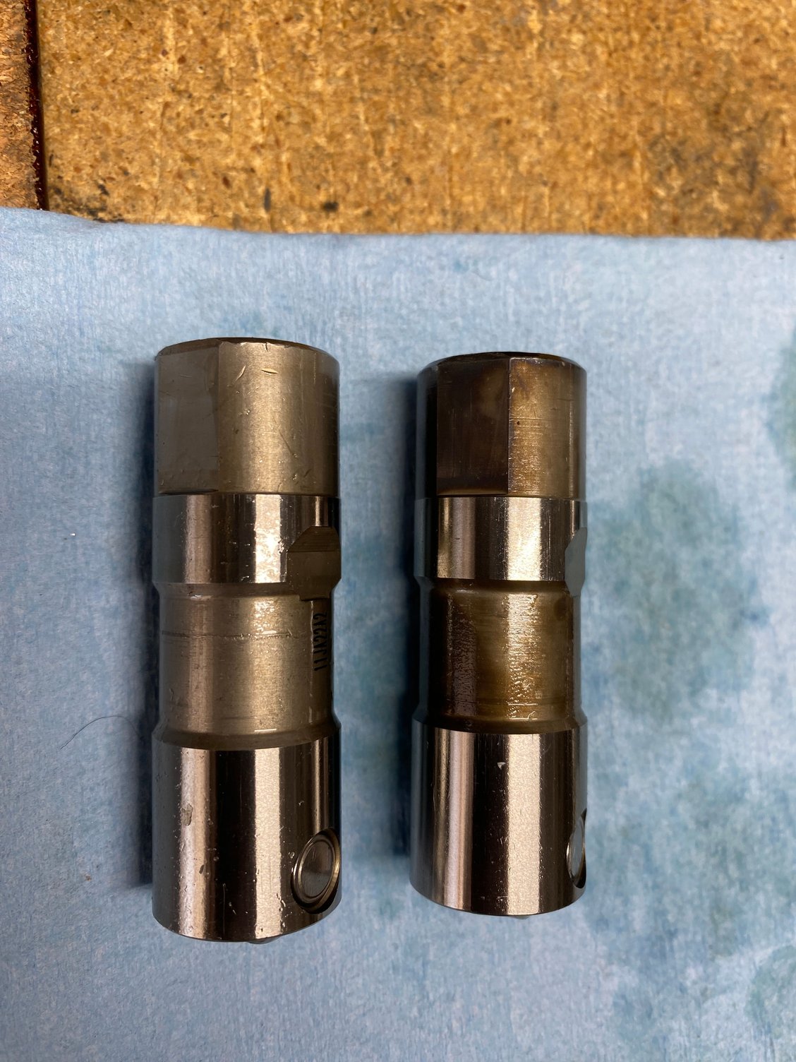

Installed SE oil pump a month ago. Seemed to run just fine for about 100 miles. Then last week, it seemed I had excess knock type noise but seemed to be coming from front cylinder area. I got worried because it did not go away after a few more start ups and short runs. So I took it all apart, and this is what the rear exhaust lifter looked like:

Crappy oil and poor tune? Sit in traffic much.

What bike? 99 model year?

2021 Road Glide. Lifters all looked new when I installed SE oil pump and cam. Have run only 150 miles on new pump.

how are the oil change intervals?

Probably not synthetic.

Full oil change 1 month ago...150 miles. Harley synthetic

Did the engine sump possibly? The crankcase gets hot when that happens. Was an o-ring left out or wrong one used on the scavenge side of the oil pump?

Now that we know it's a M8, were the lifters removed and cleaned when the pump was replaced? Those look like 99C lifters, toss them in the trash.

All the O rings were in place. When I took the cam cover off, about an ounce of oil drained out. The lifters are S&S premium. about 1,000 miles on them
