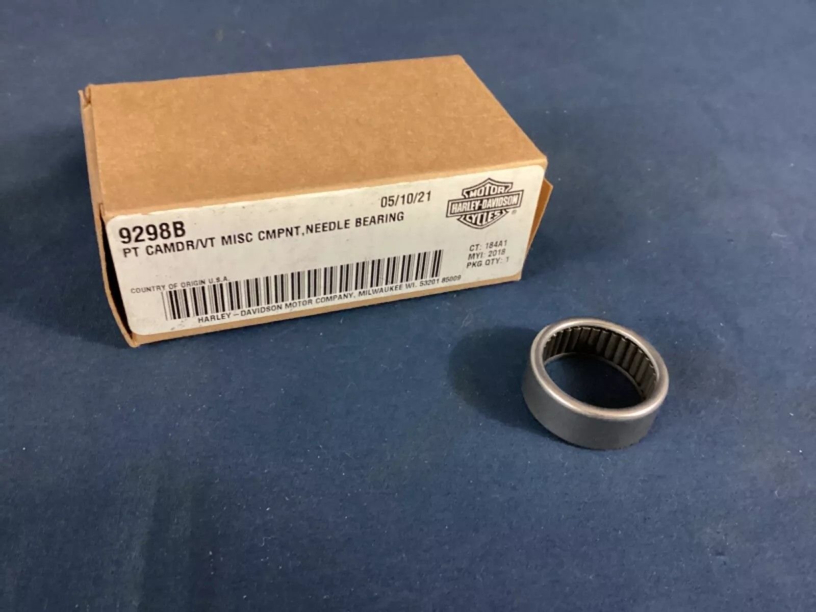

You might have a B-168 in there. Someone posted the other day that their 2023 or 2024 had the B-168 in there from the factory. HD has them as a standard part number for a few years now. 9298B NEEDLE BEARING, CAMSHAFT.

Will I be able to tell if it's a B-168 without pulling it out? Can I tell by looking after removing the cam?
