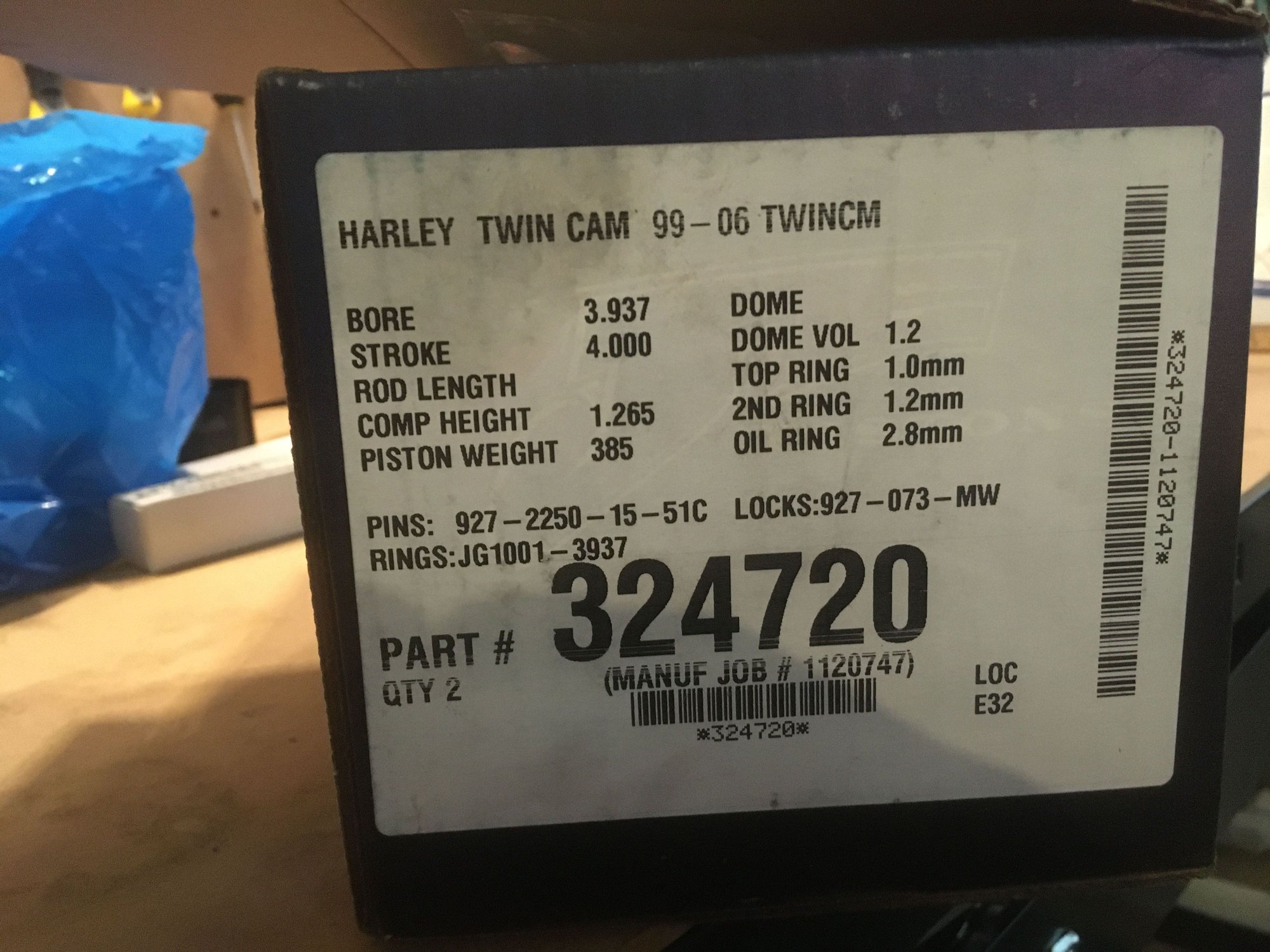

Hello Sir, JE Pistons with dome +1.2 CC. All data is correct as far as I know. It ends up in 1:9.6 static compression.
I have grinded the chambers to accommodate them to the difference in deck height. Average CC is 50.1.
The milling, done by a machine shop, (who also drilled for the compression releases), was done before I grinded the chambers to average 50.1 CC and it should be only 0.2 mm. This would be 0.008”. But should not effect the compression as I adjusted that through the chambers.
The cylinders were bored by another small machine shop, (founded 1958 by the guy´s grandfather). I installed everything myself.
Link to the piston at JE: https://www.jepistons.com/product/je...-bore-right-4/ As the site says it is a 1:9.5 piston.
Here is the piston package, it says 1.2:

With everything you say you have in the motor w/50 cc heads your comp would be 14.8:1.. To get to 9.6:1 you would have to have 85 cc combustion chambers, and you should have no issues with the 37 cams. Forget the 54 because your early heads with stock springs will not accept cams with a lift above .520"

Sorry Sir, you are perfectly right. "50 CC", (I do not why I wrote this), should of course be 85 CC.
Front is 84.8 and rear is 85.2 CC. Deck height front is 0.005 and deck height rear is 0.002.
I am sorry for creating this confusion. I must have had a "momentary laps of reason", as Pink Floyd would have put it.
