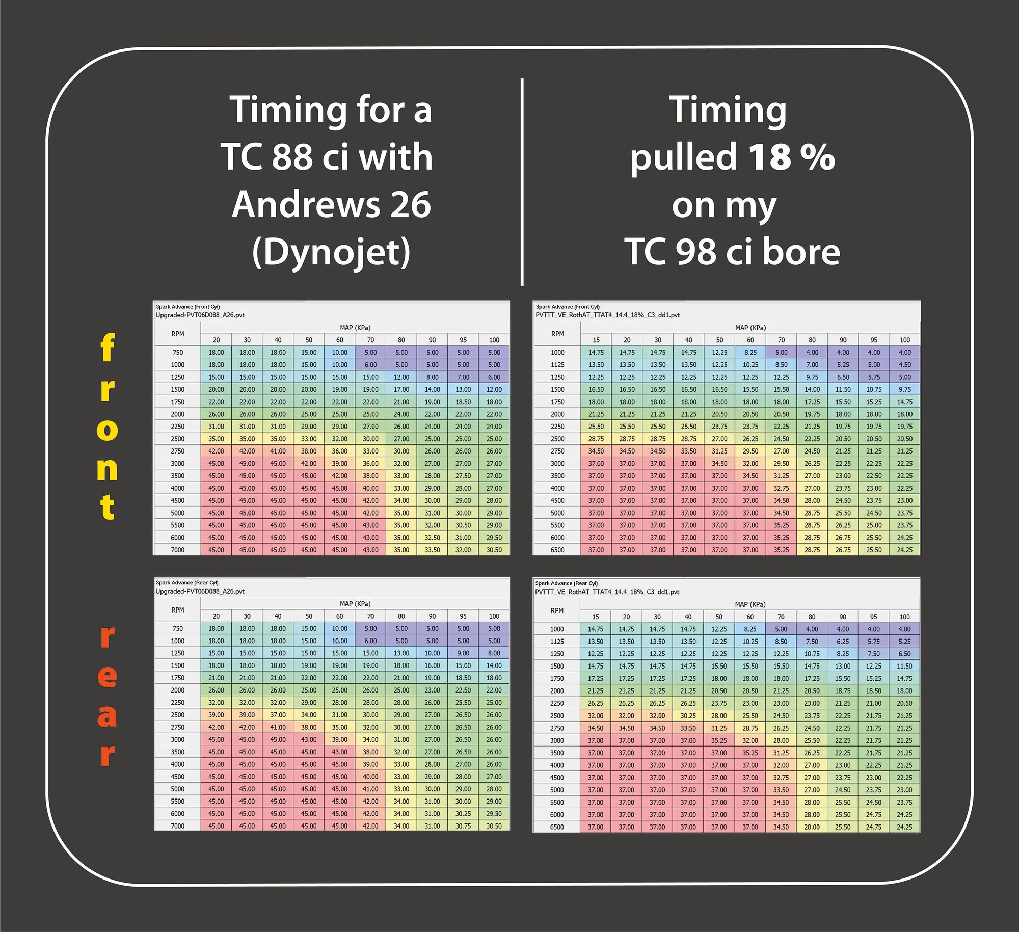

Here are the spark tables I have used. One before the big bore, and one after where timing is pulled 18 %. There are minor differences from a mathematical decrease of 18 %. I think I might have used the smoothing function in WinPV, so it is not exact 18 % everywhere.

Originally Posted by OakMountainRider
Thanks Max, it is always great to get opinions, experiences and knowledge through this forum.
I have actually scratched my head more than twice wondering why my Cold Cranking Compression is so high. I even sent my manometer to be checked, as I thought it showed too much. It did, but not that much.
Been thinking of Andrews 37, or even 54, to bring the compression down, but have not decided yet. Maybe I just seafoam it this spring.
Anyway, bike runs fine and does not ping anymore, in as the ECM does not count any knocks - this after I Autotuned it several times and pulled timing 18 % from the tune (received from Dynojet when I changed to Andrews 26). Especially it stopped pinging after I removed the DK Custom torque plates in my baffles, which made it ping as soon as I twisted the throttle.
(When I say pinging I refer to knockcounts seen on the Power Vision. I have not heard any sound as my hearing is not so good.)
If you like the power you are getting I wouldn't change a thing..
Too many think that retarding the timing is only going to lose power.. When you have higher cylinder pressures before ignition and the spark occurs, the air/fuel mixture is going to burn faster. Faster burn requires that the timing be retarded over the previous build because the peak is happening to close to TDC and energy is wasted. I forget the ideal peak pressure location but it's somewhere between 10-20 degrees after TDC. With nice thing about digital map based timing, you can set the timing more precisely and it won't change once set.
As far as the baffle causing the ping goes, that simply means the cylinder fill was truly higher in those locations and if corrected in that area, the motor will make more power. Timing curves are not all the same. They do not have the same general curves across different builds. You should be able to reinstall the baffle, find where ping events are recorded and remove timing from there..
