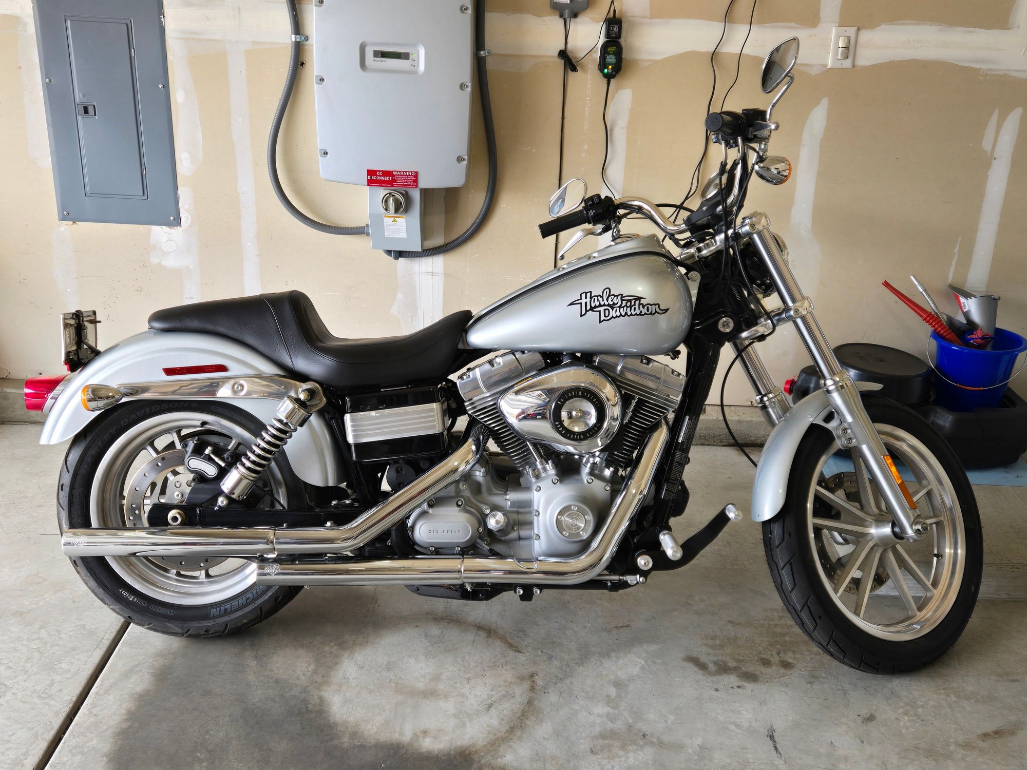

Howdy all, I have a 2010 FXD Superglide. Low mileage stock 96 with V&H HS slip ons, Arlen Ness Stage 1 intake, and FP3 tuner. I finally decided on cams. After some research and talking to fuel moto, the recommended Woods 222 cams. Anyone with a Dyna running these cams. How do you like them and was this a good decision for a single rider in town along with highway riding?
