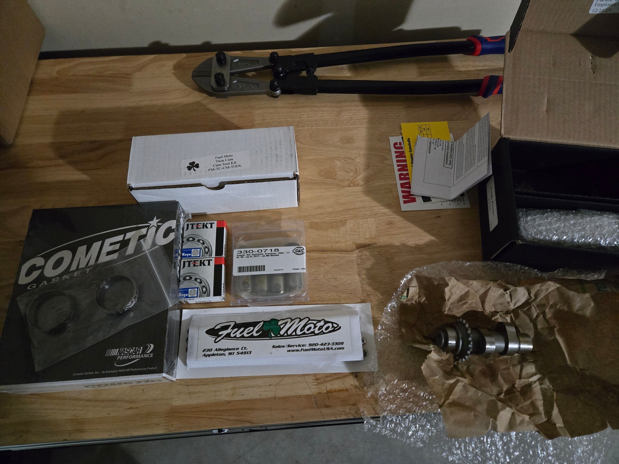

In a stock 96"er the Woods 222 is probably the best choice..
In a stock 103"er I would say the Woods TW5-6, only because of the bumping compression from 9.2 to 9.6..
yes this is a stock 96 with the exception of the stage 1, straightshots, and fp3. Im looking forward to the swap 😁
