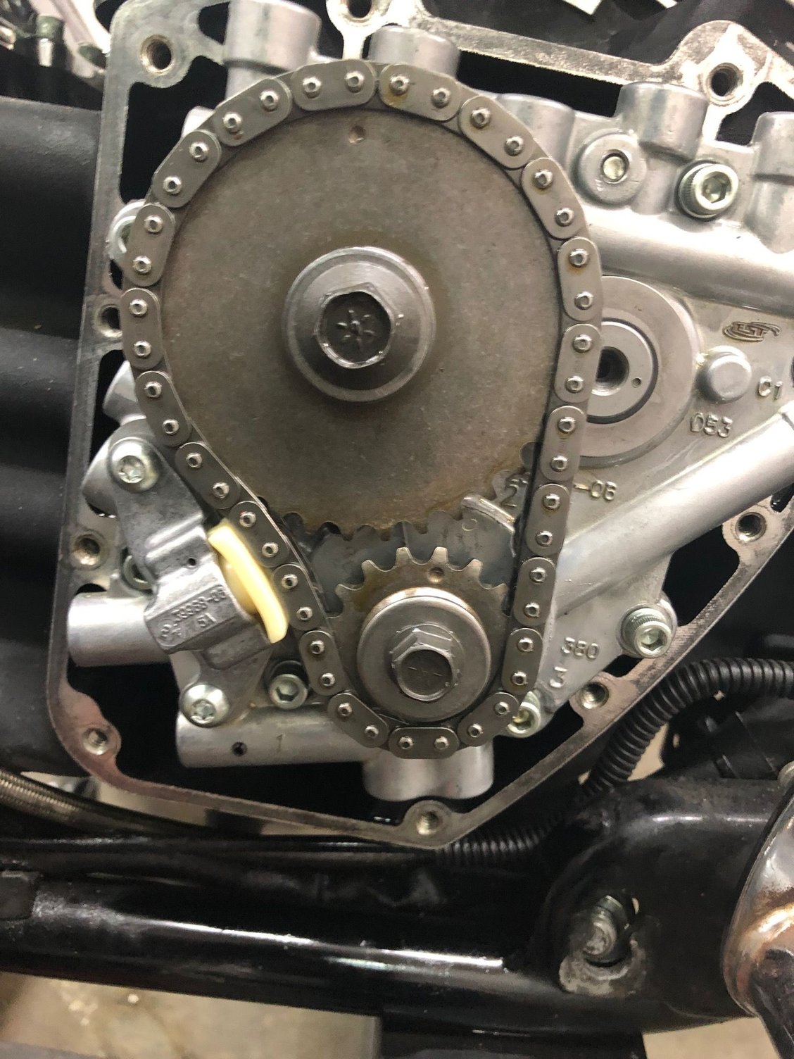

Your front pushrods may be loose. This is how the dots line up when on tdc compression for the front.

I would at least check the rears and readjust the front, only takes what 20 minutes? A trick is to reach into the lifter blocks to feel that the tops of the lifters are flush with the roll pin to
confirm tdc compression.

Are you talking about the metal lifter retaining pin? Make sure the top of the lifters are flush with that metal pin? Do that on each cylinder when making pushrod adjustments? Do you think I did any damage by starting it and idling for 30 seconds?
