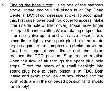

None of us were there when you did the work, so don’t take anything posted as criticism.
Finding the base circle during disassembly and assembly is a pretty important step or bad things can happen.
