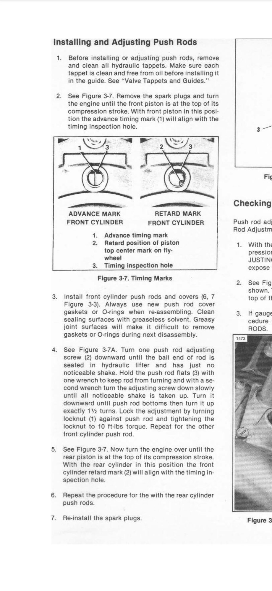

Loosen the 2 screws for the timing plate.. Where those windows are under the screws, put them in the middle and lock them down.. It should start... If not, it's very possible, you adjusted your push rods too much herefore, you have no compression and engine.Doesn't want to kick over... Here's the proper procedure to adjust your push rods properly..

So the advance mark the front piston should be TDC?

Yes.....

Ok that’s what I was thinking but I’m on the mark and my rear cylinder is at the top
