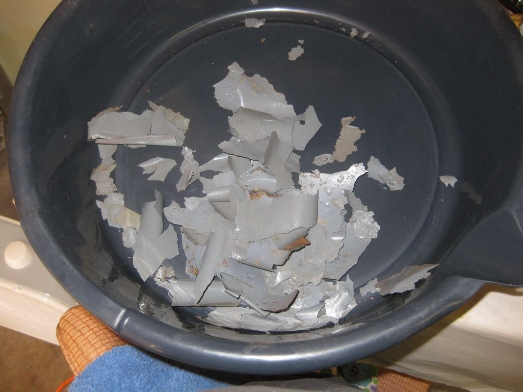

I had an issue with my bike a month or so ago. I was headed to a swap meet and she was not running right - if I tried to accelerate, she would just loose all power. I pulled over and saw the carb was overflowing. I made it back home and pulled the carb and all sorts of nastiness was in the bowl. I pulled the main jet and it had a big piece of crap in it.

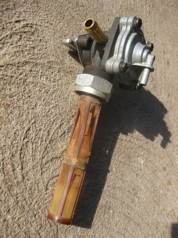

So I drained the tank and pulled the stock petcock. What a frigging mess, here is a photo AFTER I cleaned it up. It was not this bad before I removed it but as you can tell - it was bad.

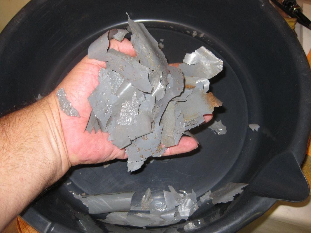

While cleaning the petcock, I realized there was a lot of tank liner that was flaking off as well as a bit of rust. I took the tanks to the car wash for a high pressure clean and then cleaned the tanks with Metal Rescue for the rust. After the tanks dried, I realized I had a big mess with the original Harley tank liner. I put a hand full of nuts into the tank, rotated and shook them for a long while and then removed the mess with a magnet. The last step was a rinse with 50:1 2 stroke gas. Most of the mess was removed. Now Pearl is running like a top.
