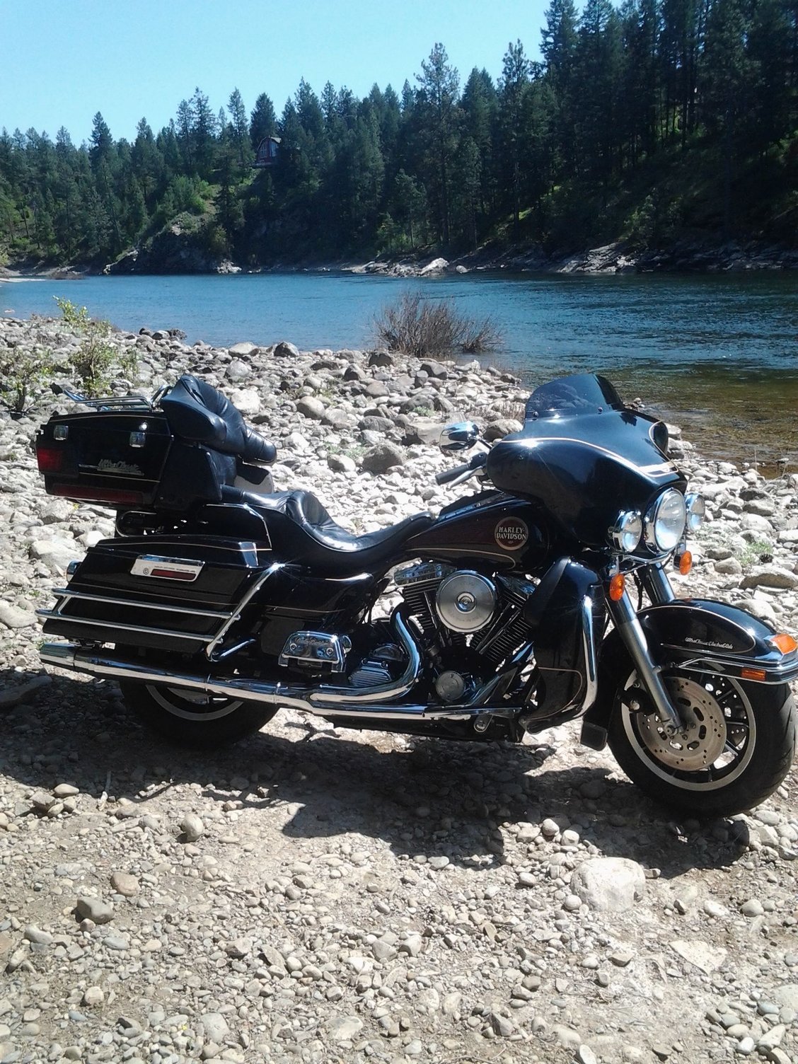

Thunderheader showed up early! Have never changed header pipes before, only slip-ons. Used the tapered gaskets, and after reading a tip somewhere on here, used a flat washer to push the gaskets in evenly. The pipe came with a bracket to replace the stock one, so the transmission side cover had to come off, and the oil filler cover too. She smoked a little around the exhaust ports when she first fired up. Thinking it was the anti-seize on the cylinder head studs, or the gaskets seating in. Rode her around 80 miles, re-torked the studs twice, haven't heard any leaks. She sounds great! (Like a Harley) kind of a deep tone with a nice bark. Have heard many people say they're too loud, but i don't think they're too loud at all. My wife can still hear me yack to her while riding together, I wouldn't mind if they were even louder. Bought the heat shields too, but personally think the pipes look better without. Put them on anyway. Just wanted to update y'all with my first 'up grade' am more proud to hear her run now.

Am going to 'try' to post a pic of her..

Damn nice look'in scoot.
Have used both the flat and oem gaskets both have worked.
I'll side with T man I like using the oem copper ones myself.

Ten four, my indy only had the stock type, will try the copper ones next time just to see the difference. And thanks about the bike, picked her up a year ago with 38,000 on it. She's a 96.

I am a firm believer in the 2-1's and especially on a bagger so you don't have that cross over pipe bull ****. Nice bike and nice exhaust. Good choice

Sharp ride Thirsty!
