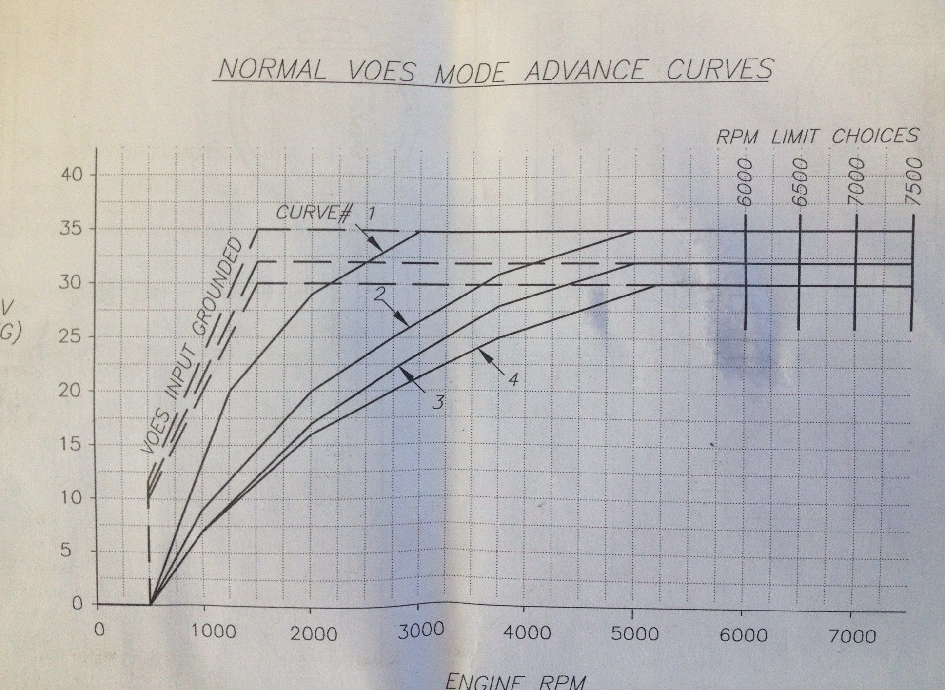

At the most curve 2, I actually run curve 3 and like the torque at low end better.....no pinging.......

set up timing back to 35* degrees, then use #3 curve, which is 32*
whats the cranking pressure (compression test with throttle wide open and slide raised if running a CV)?

[QUOTE Ran that 89" with perfect AFR at 10.0-1 40 intake closing cam and had to run 2nd single or 3rd timing setting loaded, Know that engine well
This paragraph last night was not a guess on timing
