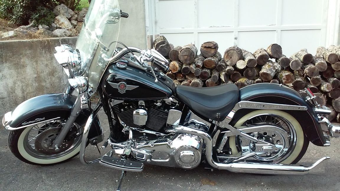

1995 FLSTN Heritage Softail, EV-3 cam, 20K miles.

Love those fishtail pipes!
