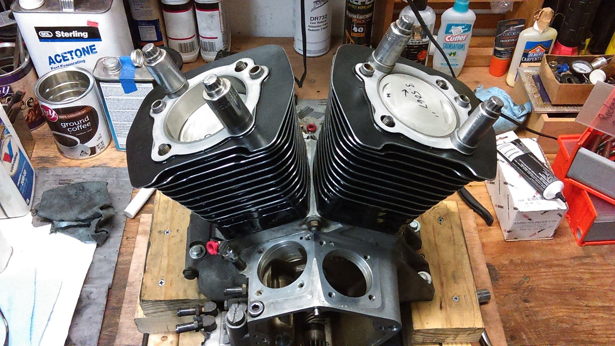

Jugs with pistons are in place and ready for heads tomorrow.
Instead of the washers and sockets. You should get some schedule 40 pvc and cut 1 1/4 lenghts. Works perfect and doesn't mar the surfaces.

I didn't have any but I barely snugged it to not mark it up so I could rotate.....

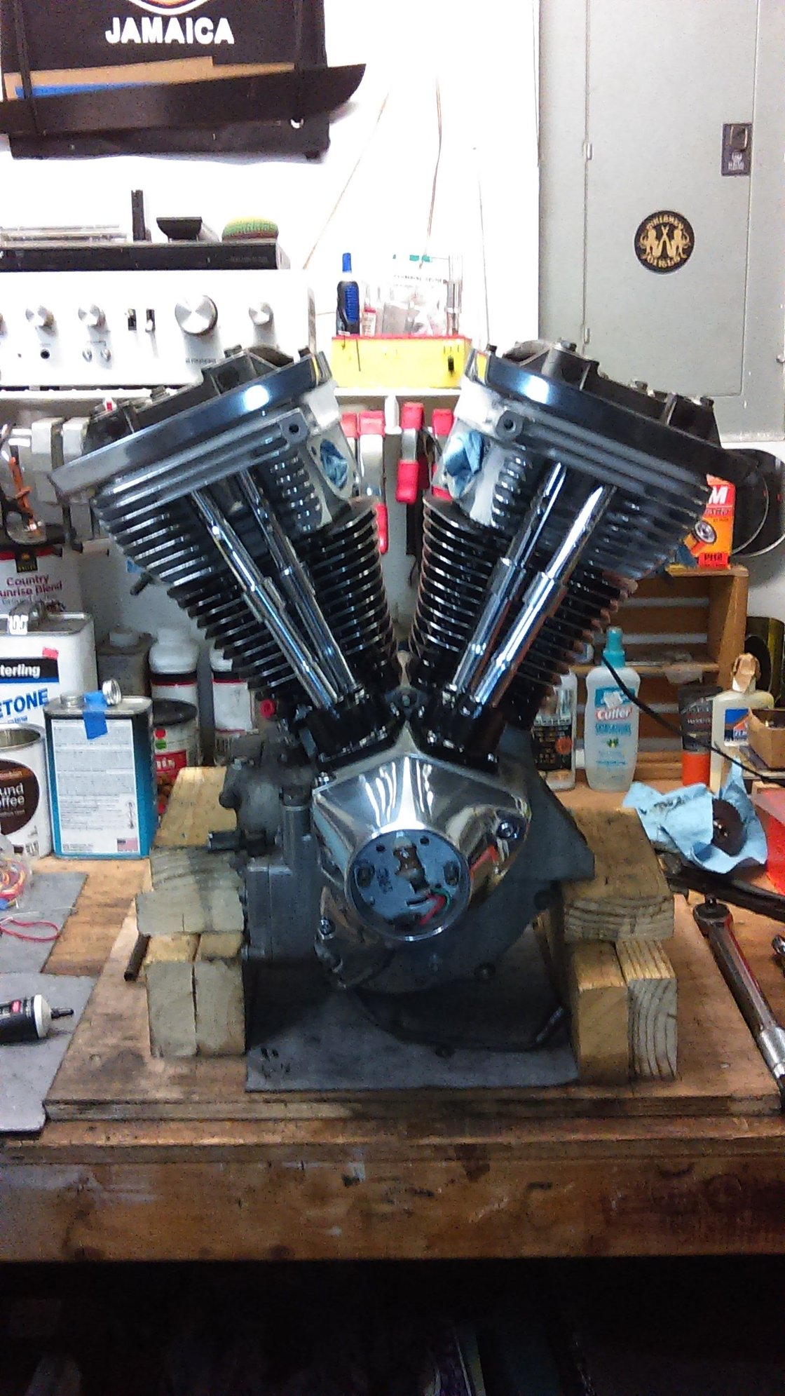

Cam is in along with a new plastic breather, seal and bearing. screaming eagle lifters, blocks torqued down. Heads on and torqued down.

Looking real good, Glide...
Not able to do anything with mine. When I picked up the heads this past weekend, Scott"s machinist noticed a funny wear to the rings and after a good look, looks like new rings. Actually if it wasn't for him I would be rebuilding again soon. So still waiting...

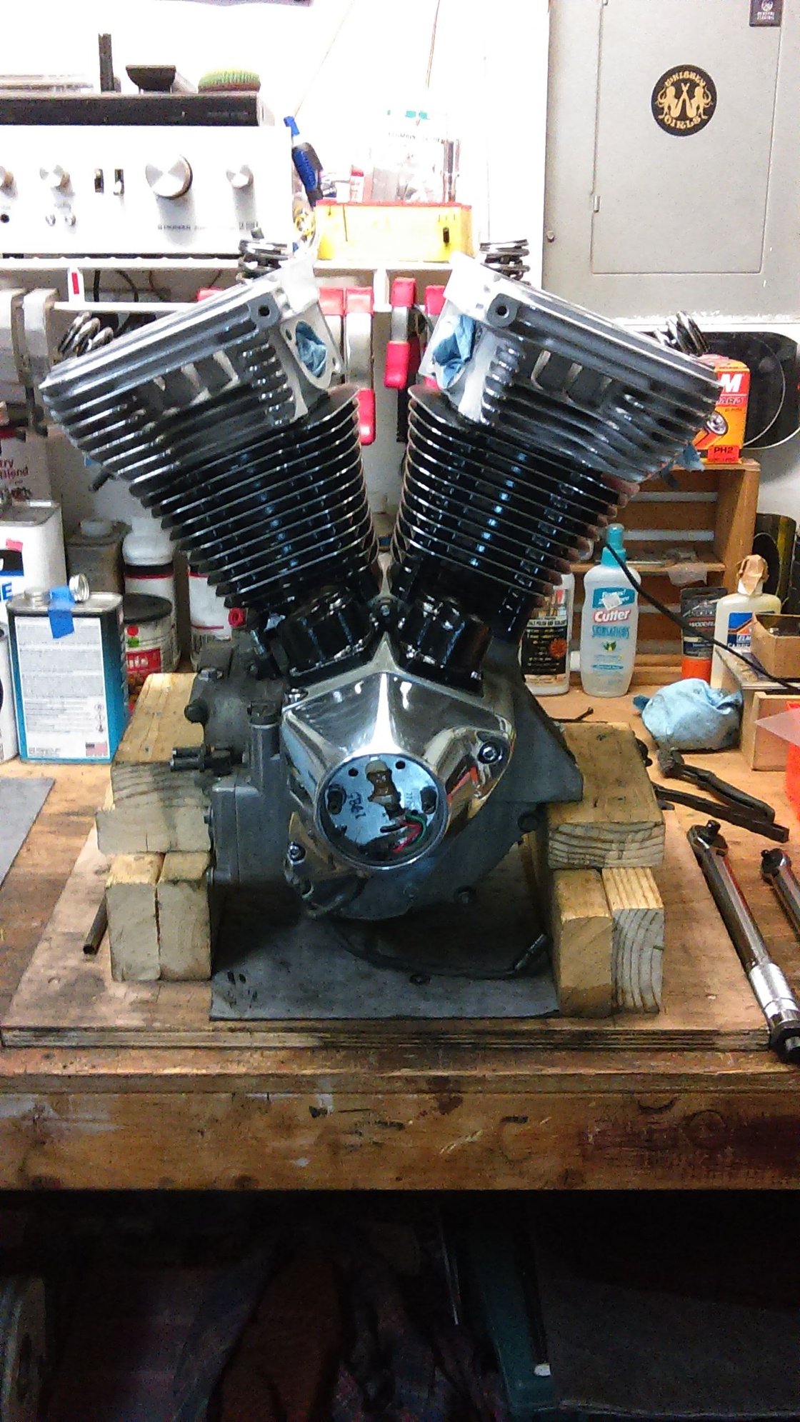

Just installed the s&s push rods, lower rocker box torqued down, that's it for tonight.

All set and ready to go back in, hope I did this right.

Looks all shiny. Great job. And when it starts you will feel soooooo accomplished. I love that feeling
