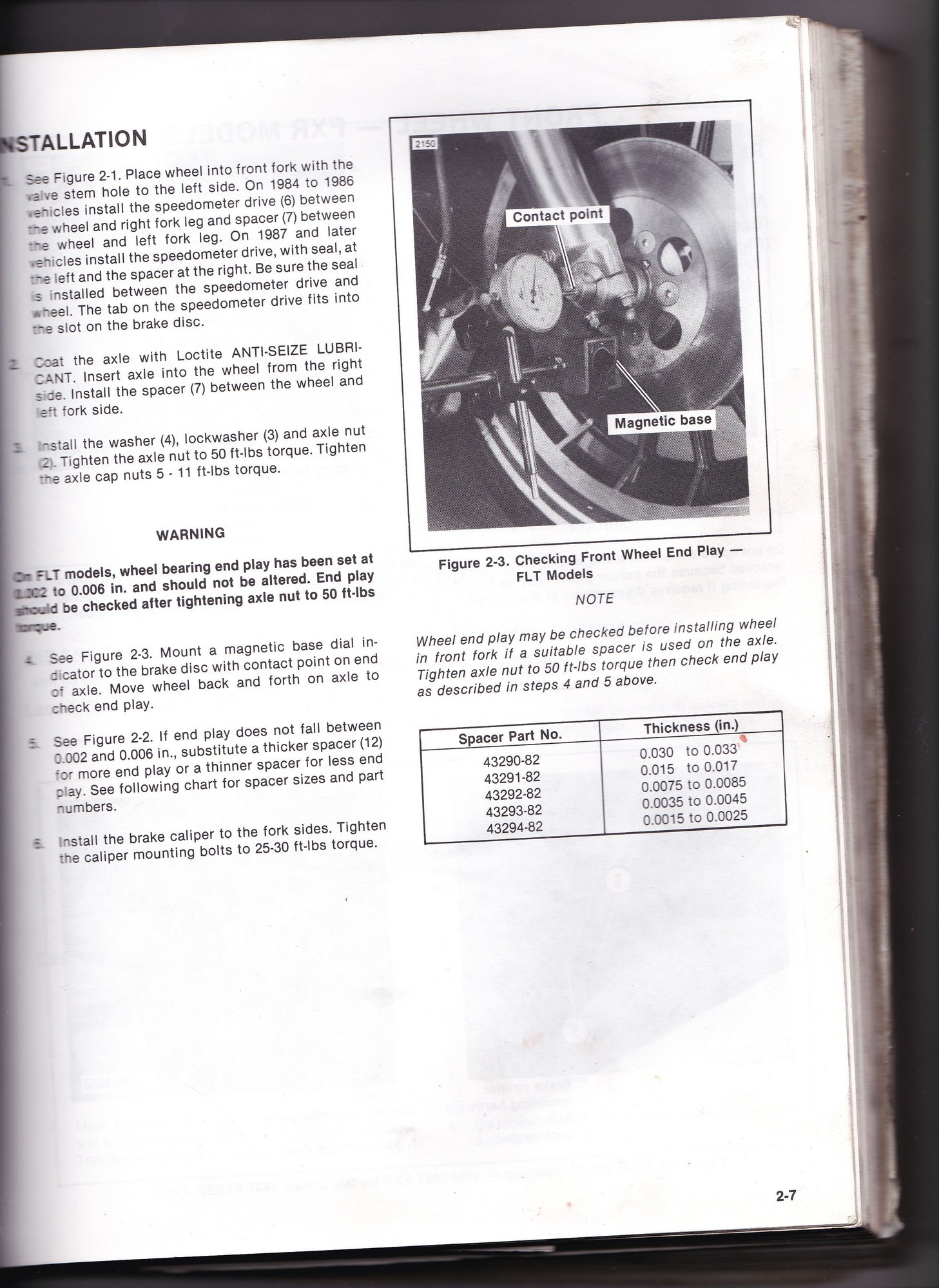

1990 FSM 99483-90, stem on the left, turn it around and you will have rotor spacing issues
