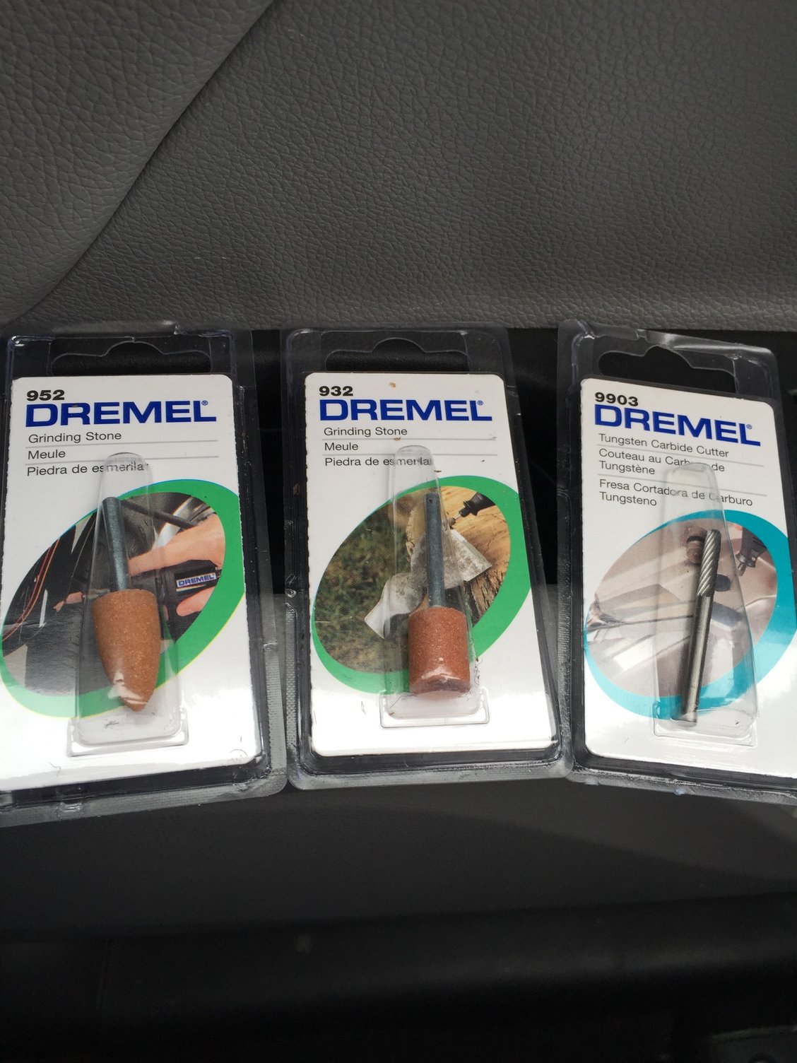

I'm not going to try and dimple them read you need a special tool to do it properly plus I'd have to repull the harness out and basically start all over. I'm thinking of trying with the dremel and a round grinding wheel. I have to look to see what they have. I think a cutoff disc would work but I think it might hack it up too much. I don't know how well the dremel will work.
I would use this one if I were you.

Just walked out with this one. Looks like I grabbed the one you suggested. Should be easier to do than with a cutting wheel, no extra slice past where I need.

Slow and precise with a grinding bit... cut off wheel will be kind of hard when it's time to cut cross ways. To do the dimples you will need a special tool for sure, and a press probably.

Yes I'm well aware of your sarcasm! Although smashing it with a hammer wasn't far from my mind when I turned the key and circuit breakers started popping. Won't be far when I go try and get that service loop back in for the second time either! I updated the post above my picture didn't load for some reason. I got the cutting bit and two small grinding wheels. I think it will work out okay, we will see.

Tungsten carbide will be your best bet for small work. The pointed one can leave a bevel that can cut into the wiring if you're not careful.

Dremel worked well. Used the carbide bit and ended up needing both grinding stones to smooth the cuts and round it out. The bit was really hard to cut straight even at low speeds it wanted to bounce around. Got the clutch side on nice then did the throttle side and come to find out the flat spot for the master cylinder is not in the right spot for my set up either. More grinding will need to be done, it's only slightly too high but it makes everything cockeyed when tightening down the clamp. Hopefully it's a few more minutes of grinding and I should be good then onto the service loop hell.
