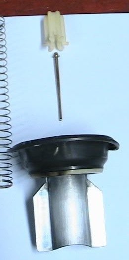

When you installed the vacuum diaphragm, did you drop the needle in first follwoed by the plastic retainer like below?

Yup sure did. Reading everything I can right now. Going to check the voes tomorrow
