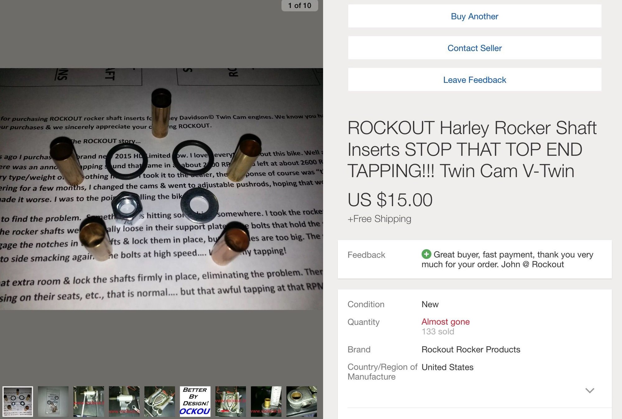

eBay. Free shipping. For the next one .

I did install one without pulling the rocker block but , on my Evo, the rocker locker bushing would not go in far enough or easy enough to pull in with the bolt. I was having to put too much pressure on it so, instead of taking the chance of stripping the threads, I decided to pull the assembly. Had there not been a lot of room to work, I would have sanded the bushings to fit easier in the rocker block. I had already bought new gaskets anyway so, it was no big deal. Just lots of wrenching!
Plenty of room with the tank removed.....
Like I said ... If I pull the rocker boxes I do the perment fix. Just drill 4 holes and tap for Allen bolts. Cost? Bout 3 bucks plus loctite. Lock it up and they never move. But these bushing are great for the guy at home with no tools.
