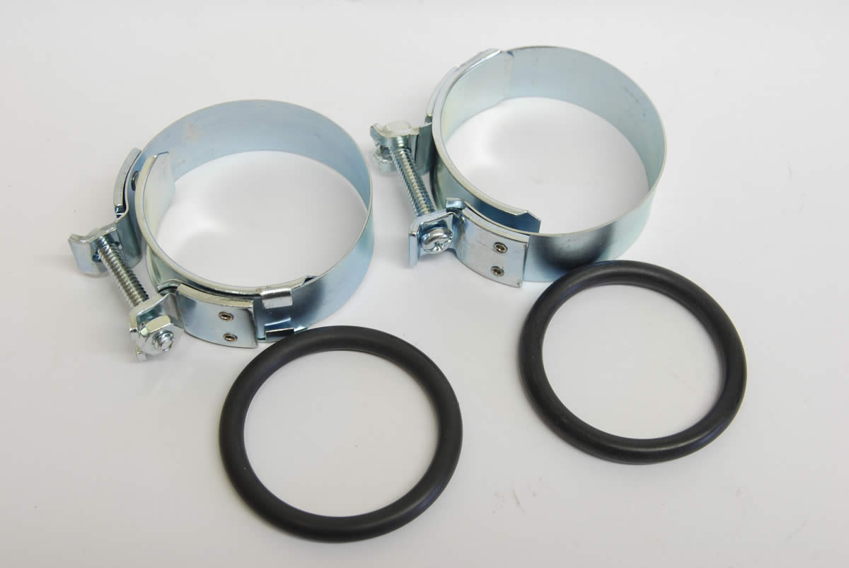

It's running the correct split-clamps that you screw together.
2 piece clamps?
There are No 2-piece clamps for Rubberbands.

Don't know how to explain but they're the correct types.

So can you direct me to a picture of the correct type clamps?
Old Aug 30, 2016 | 05:10 PM
Racepres's Avatar
Racepres
Posts: 8,590
Likes: 3,362
From: Cental, MI
Try... The oring clamps are generally just aircraft clamps or sometimes the two piece type [which I used to like but, the quality has gone to hell] While Rubberband Clamps Must be split type to work properly Note the split in the middle of a Proper Rubberband Clamp
