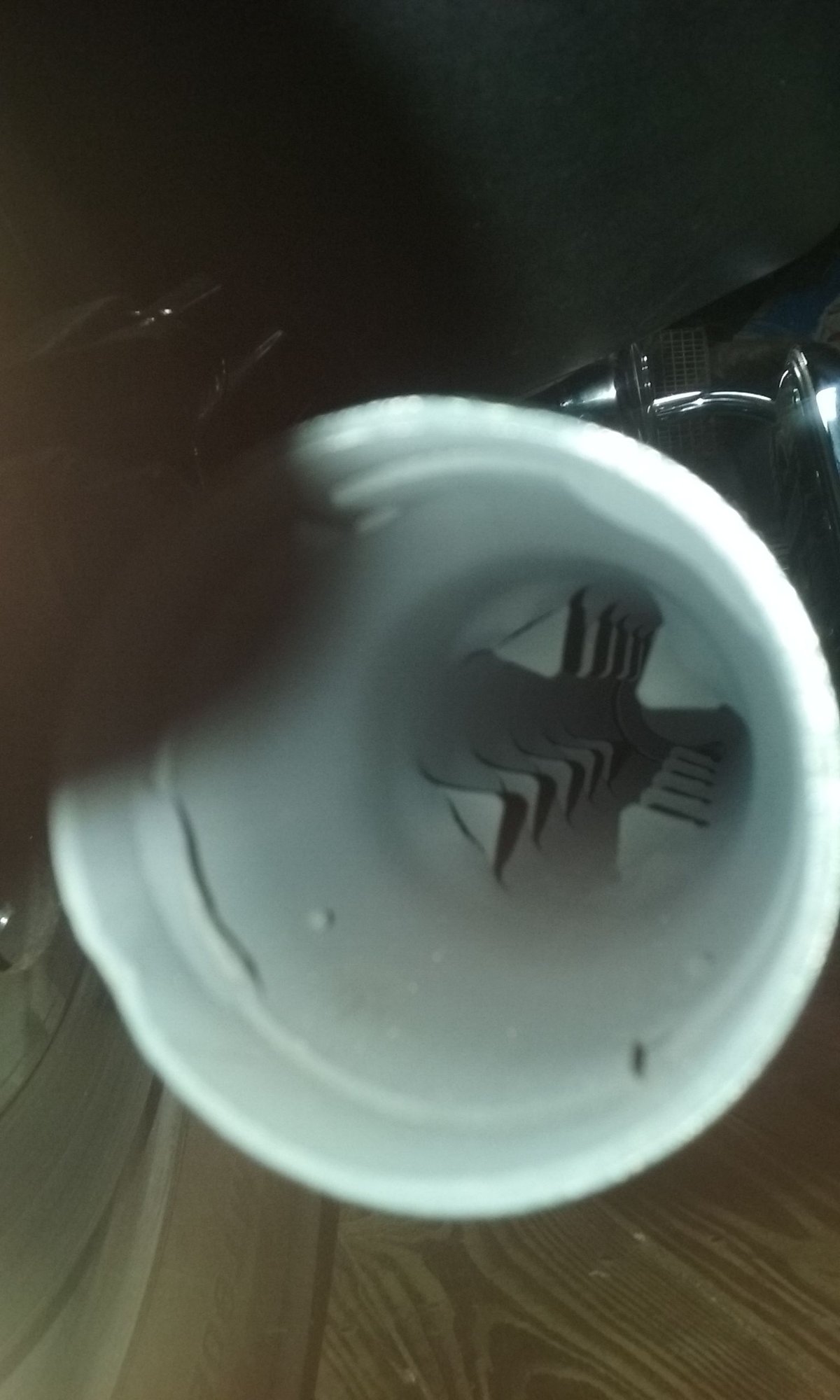

Prot. Did a quick colonoscopy on the pipes. I'm not sure what I'm looking for. Can you tell from the picture if baffles have been banged out ?

Don't tease us. I want to see the whole bike. And that is a small baffle kinda

Maybe it's just the flash, but those pipes look pretty light. Rejet and check the diaphram.

I expect the pipes to be black inside.
Do they both look the same? Is it running on both cylinders?
