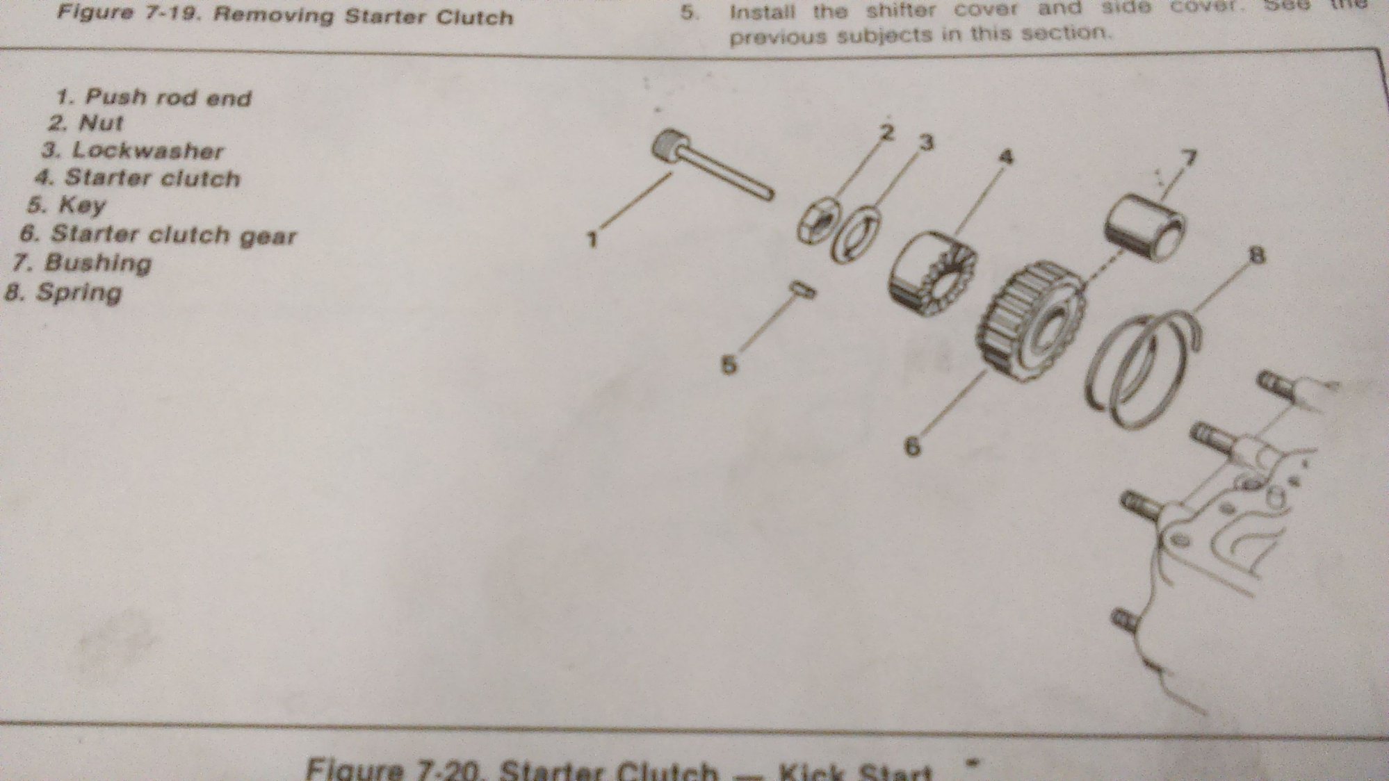

I looked in the derby a few times and saw nothing loose. As far as the woodruff key, could that be the cause? I think if it wasn't in place the tranny wouldn't move at all, the mainshaft wouldn't even move. Isn't that right?
