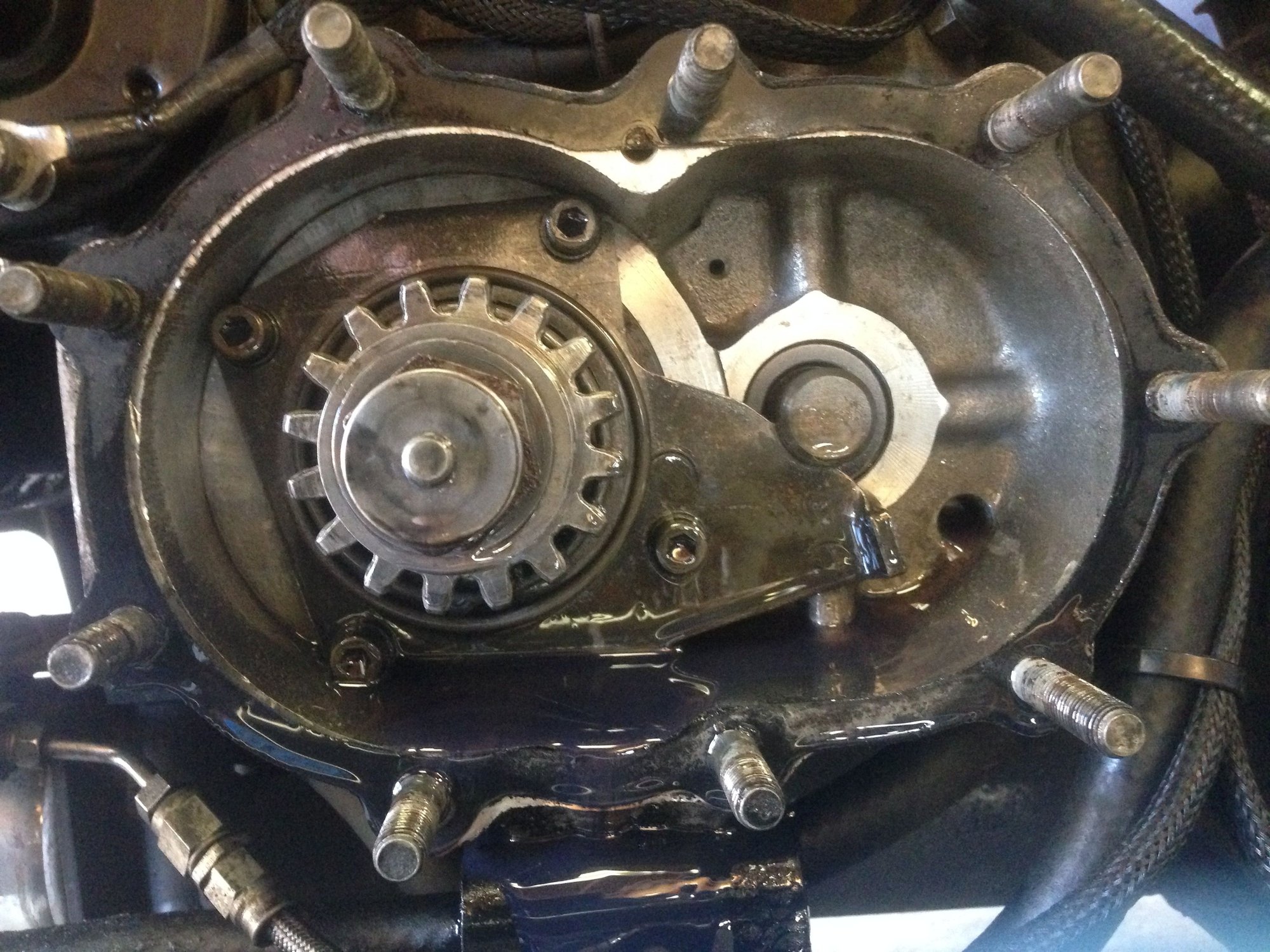

Normally I would say the throw out bearing is bad but you just replaced it. Pull the clutch and grab the mainshaft try moving it in and out. If it moves then you have a bad bearing.

Anything look out of the ordinary?

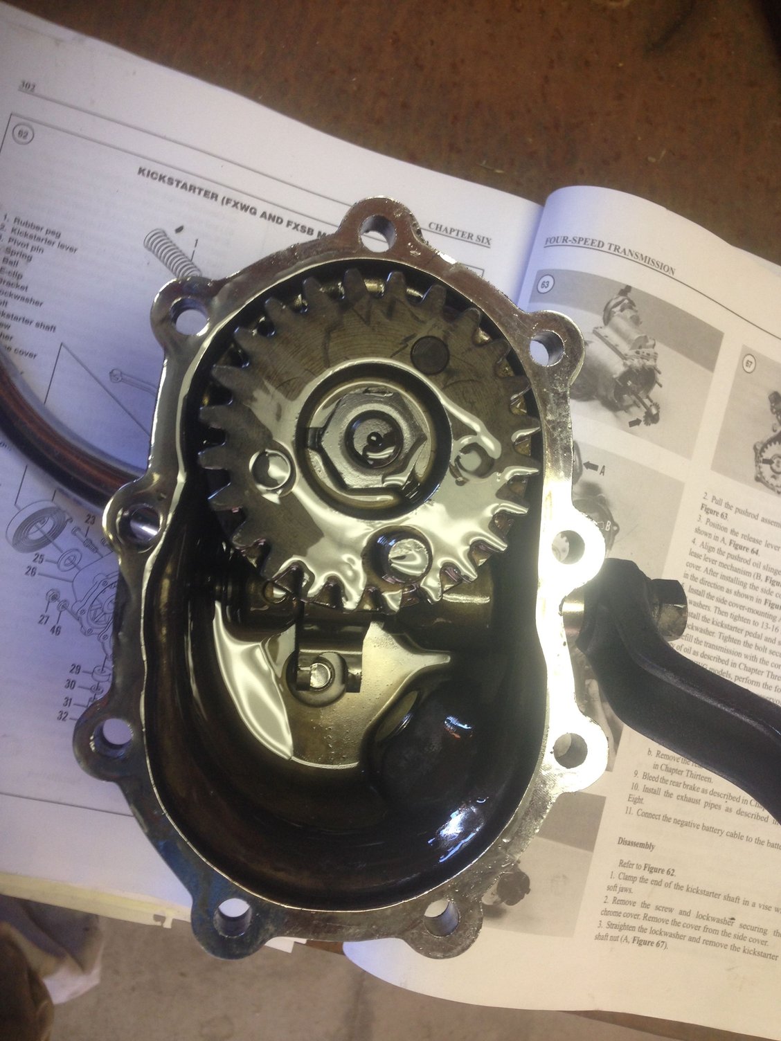

Under the derby cover I found that the clutch hub nut had backed out AGAIN! Threatlocked and torqued to 65 lbs., five pounds over the manual specs. I'm thinking threadlock and using an impact driver. How much is too much torque for this bastard? Dial up the torque wrench to 80? 90? Impact driver?

the only thing I can notice is the position of the pin on the gear is not at 7 o'clock but I assume that you probably spun it a little bit since you took it off. try what Mark said you pull in the clutch and grab the end of the shaft with a gear is and see if you can move it back and forth it should not move.
The pin needs to be in the 7 o'clock position like it states in your book when you reinstall the cover.

I just noticed your last post we were posting at the same time go back in read Post Number 38 again
