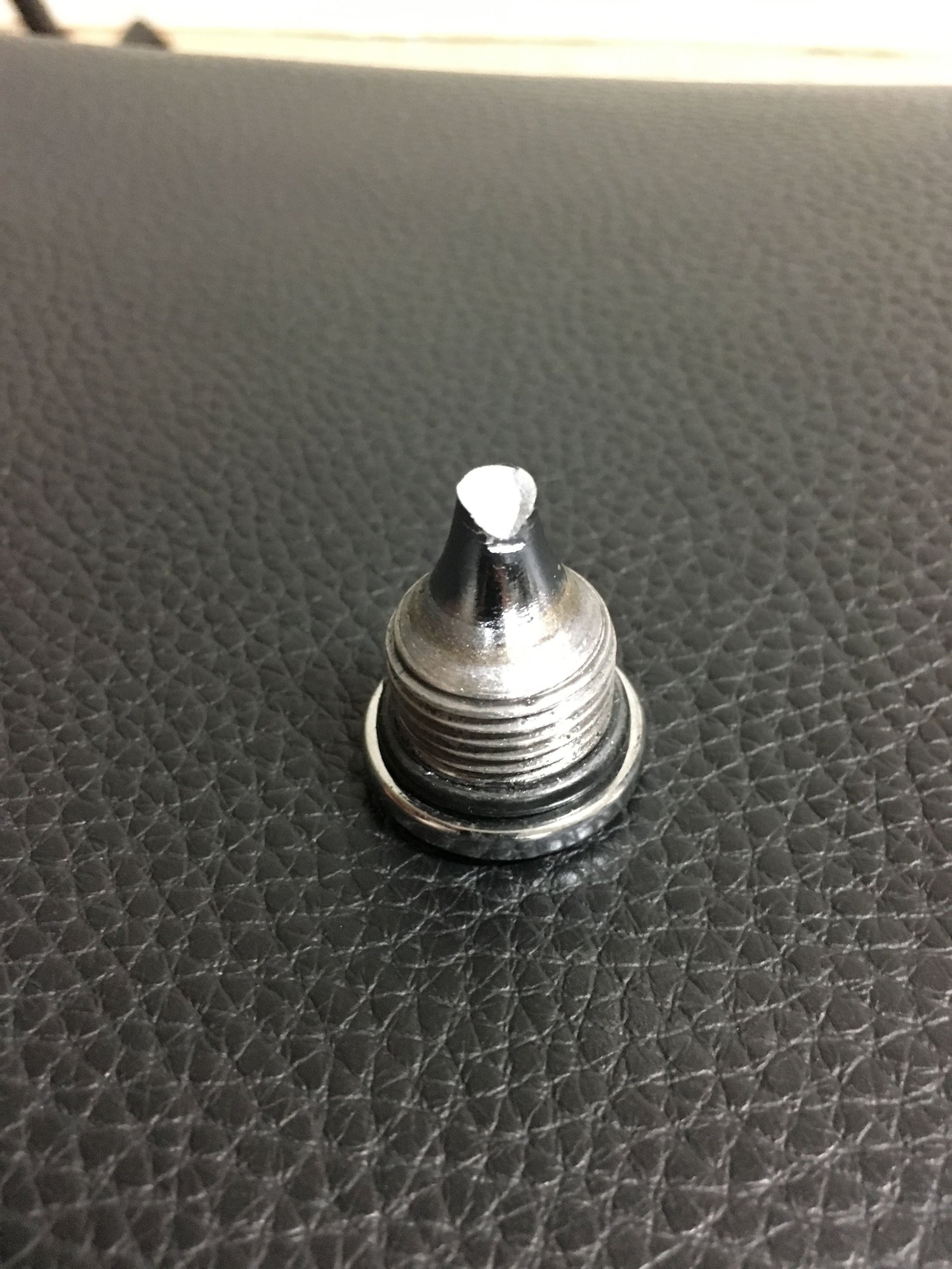

There I was...pulling the dipstick on my FXR transmission (Baker OD6 Tranny), when low and behold, something doesn't quite look right.
After using every profanity known to man in a couple of languages, I calm down and attempt to look down the fill hole with a small flashlight, but I can't really see ****. I thinking...please God, let the frigging dipstick be leaning against the side cover, and in one piece. It may be, but I doubt it. I tried a couple of different magnets fishing down the hole, but to no avail.
Just for background info, I have to add that I rode for about 100 miles on Sunday, and didn't hear any strange noises. The tranny has been working perfectly.
Before I go tearing everything apart, has anyone else had this happen on a Baker tranny? Any suggestions? I thought I would start with popping off the side cover, and having a look. That should only cost me about 5 minutes and a new gasket.
The last thing I want to do is trash a $2500 Baker tranny, all because of a stupid dipstick.

Not to try and scare you, but I do remember a post a few years ago on the same issue. It was not a Baker Trans. It was a stock trans. The dipstick got ground up and did a number on at least one of the bearings. Fine aluminum particles in the fluid.
I think it is a (don't want to say common) known problem with the dipstick. I have read that some guys just go ahead and cut the dipstick off the plug to prevent the problem.
I hope you find it without much hassle. YD

Don't hesitate to take the Cover off to inspect.

Maybe try to put a telescopic magnet in the hole to see if it fishes anything out?

OEM trans dipstick is aluminum. Don't know about Baker.
I think you're on the right track with the idea of pulling the side cover. With some luck, it will be sitting there waiting for you.
All the serous business in the trans is on the other side of the of cartridge end plate anyway. I expect you are fine.

Drain the tranny oil into a clean drain pan and see what comes out. If the dip stick is aluminum small pieces wouldn't stick to a magnetic drain plug (if one's installed) but you probably see the aluminum in the oil. Besides it would be a good time to change the oil. Good Luck.

Hmmmmm. Mine sticks to my magnetic parts tray. Maybe just the top is steel.

Yes, the threaded end cap is ferrous. The stick itself is not.
