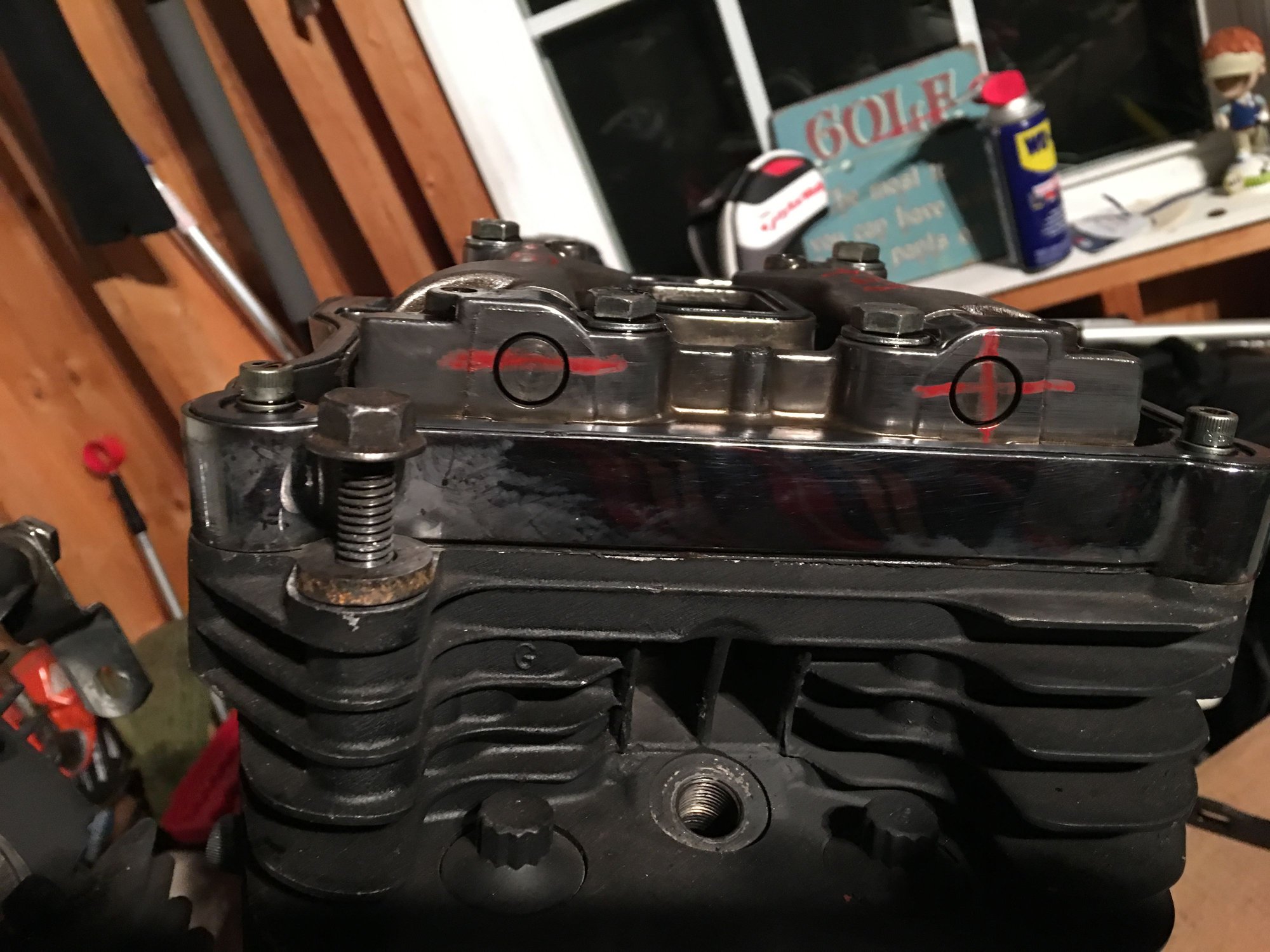

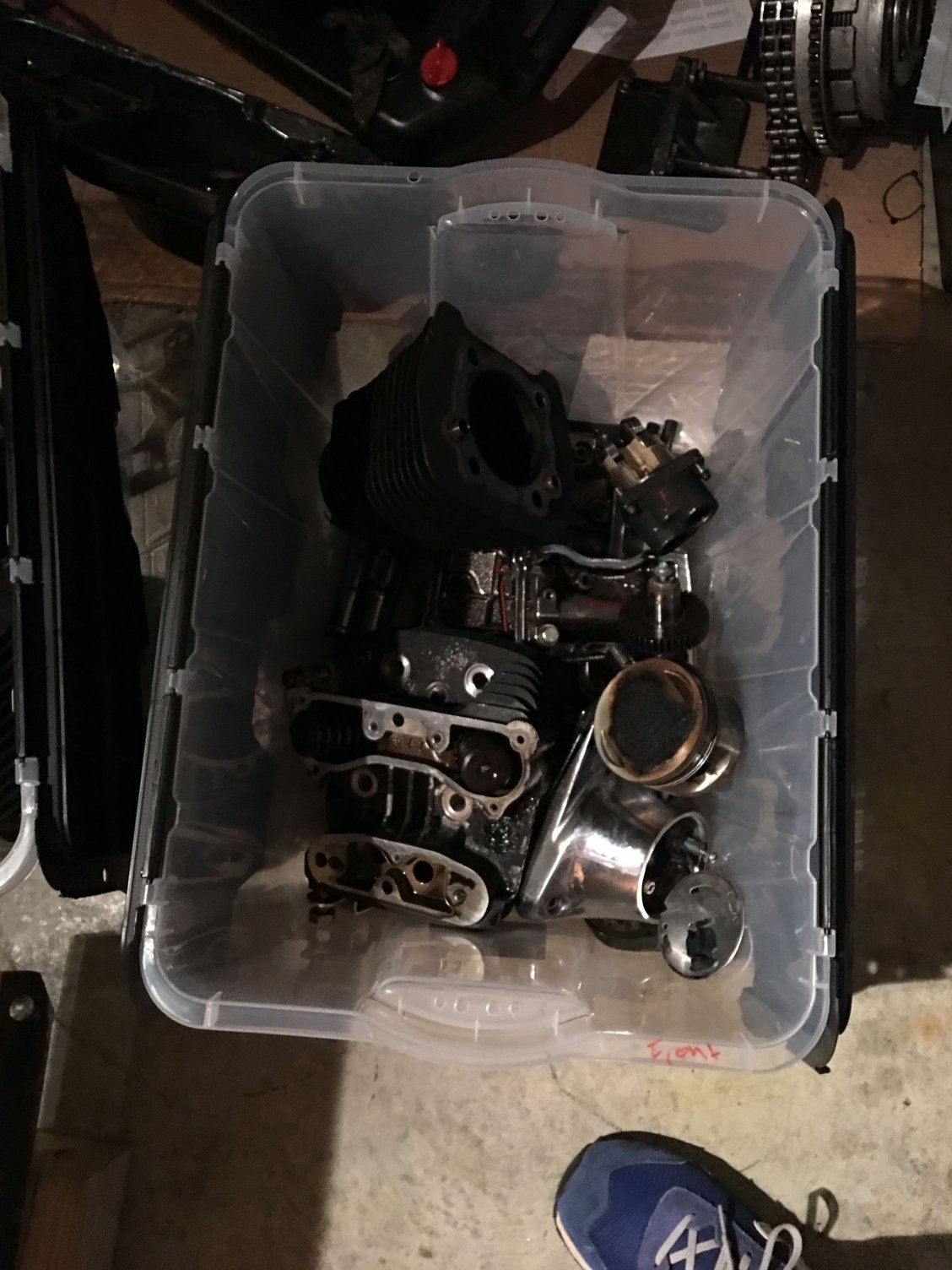

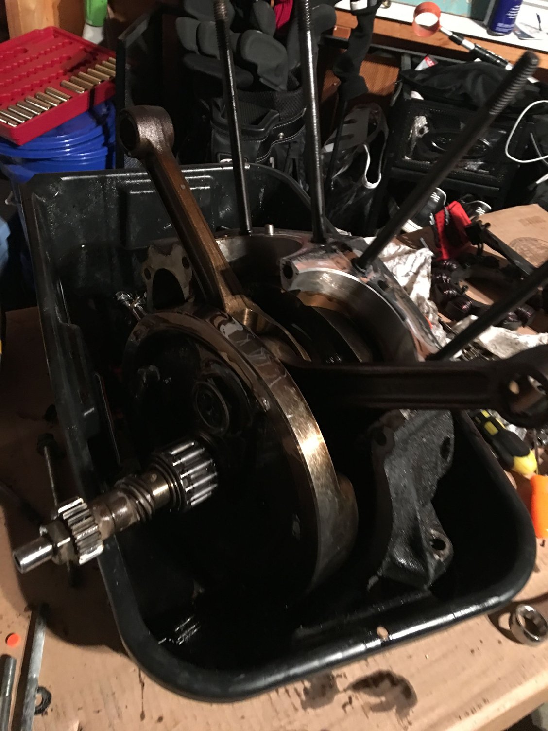

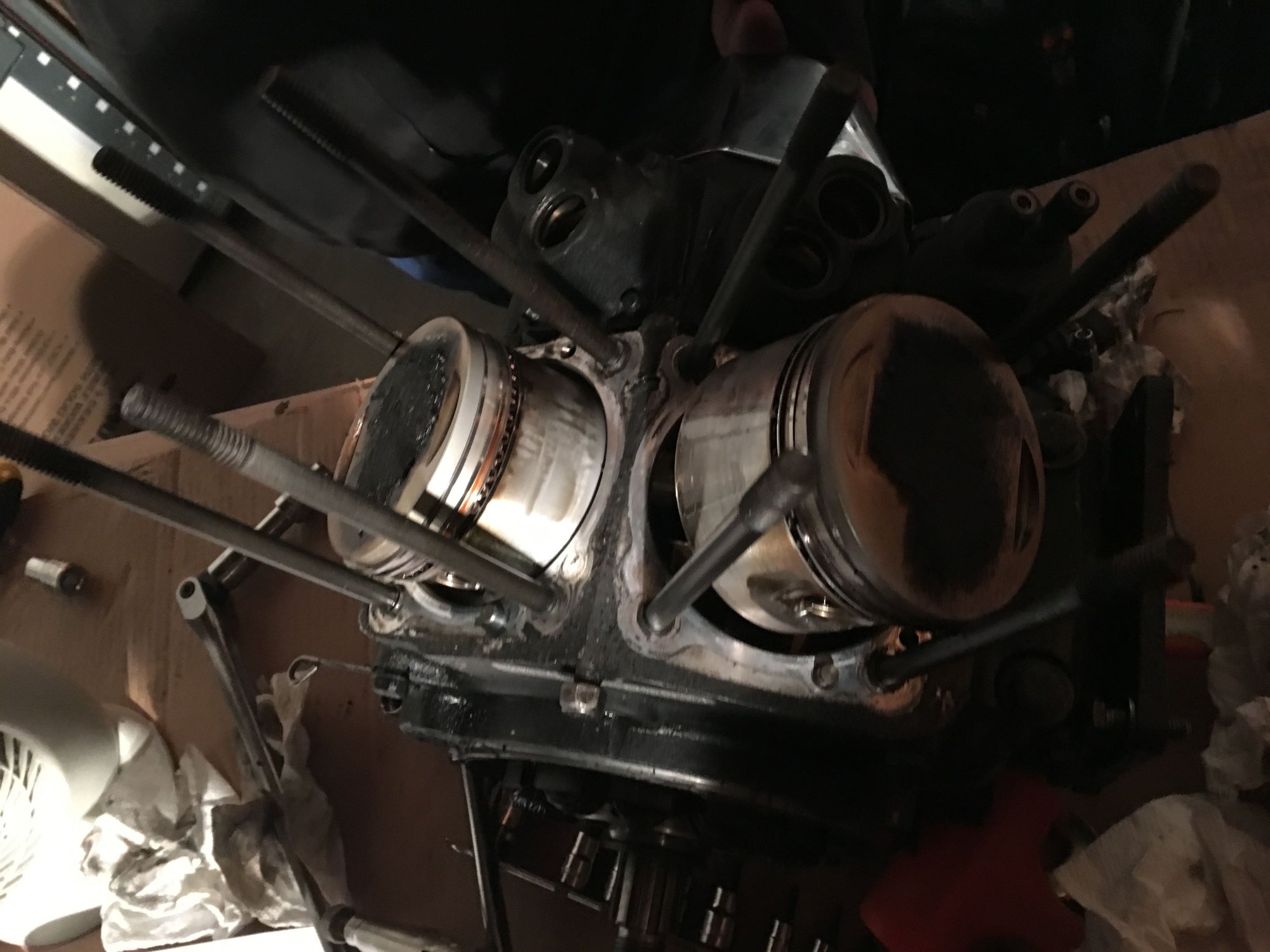

Well it's a Friday night and I'm splitting cases lol. I'm ready to go to my buddies shop to mill out the cases for the new cylinders to fit. I'm really thinking I need the stroker crank now..... man is it addicting.
Getting started
Rocker box covers off
I spy pushrods
Look some carbon covered pistons
Fly wheel
Front cylinder parts
Rear cylinder parts

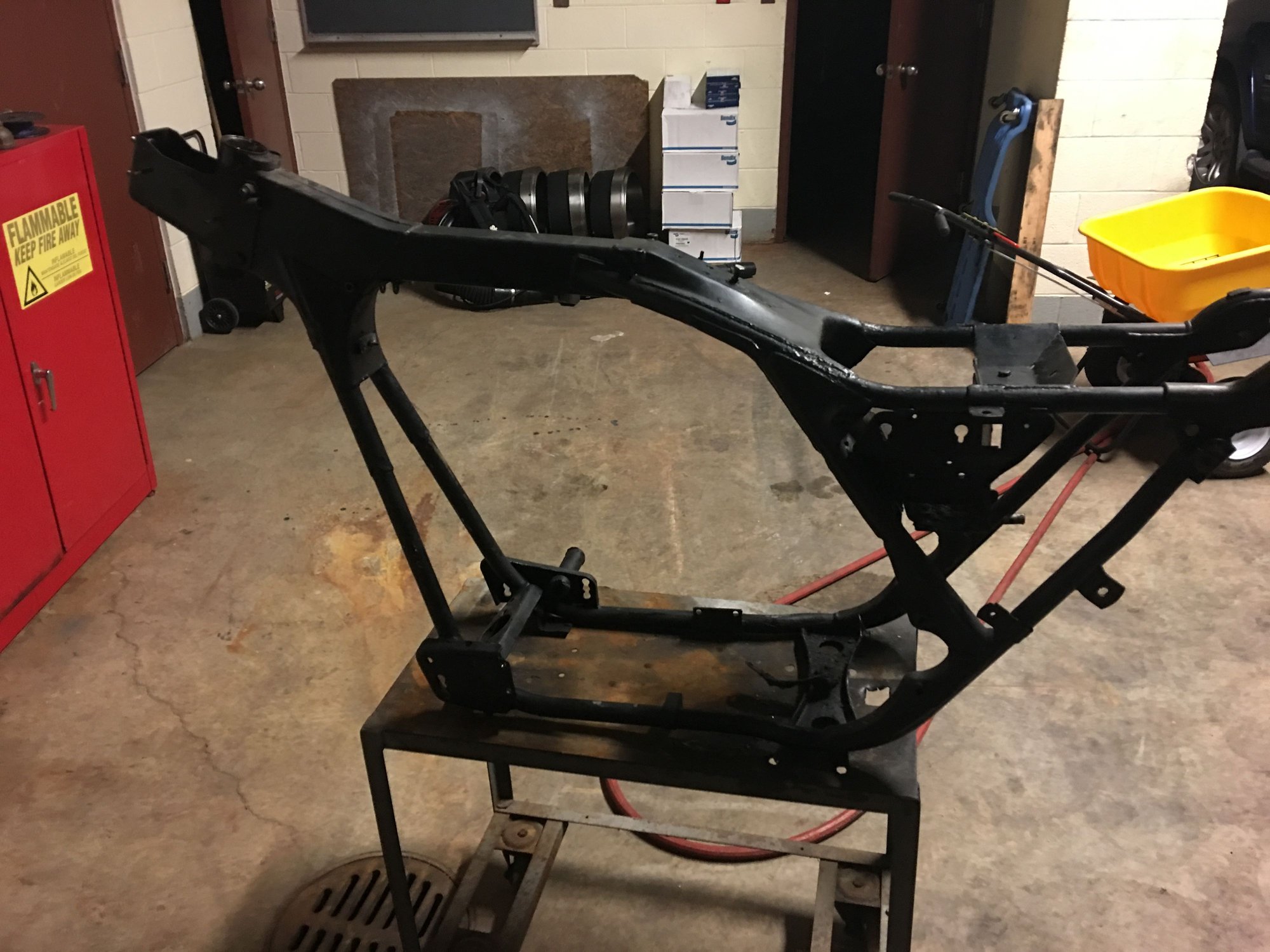

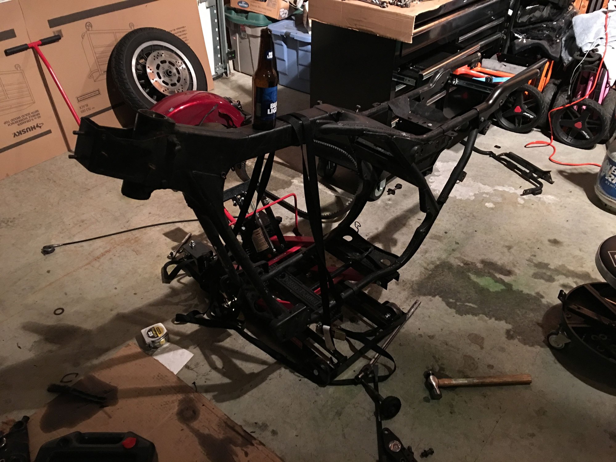

Ok so after a couple hours in the garage tonight I got the bike completely torn down to the frame. I am going to bring it to work with me on Wednesday and strip the paint off and and paint it black again. I have the motor in the trunk of my car all torn down so I can bring it with me to bore out the cases to except the new cylinders. Big things are starting to happen finally and I'll be able to start putting **** on the frame instead of removing it.

i started trying to paint strip my frame last night and I can tell you that the factory coating does not come off so easy. I thought I would pick up a soda blaster but have decided to just have a local shop sandblast it for 65 bucks. I think I should of done this from the start.
