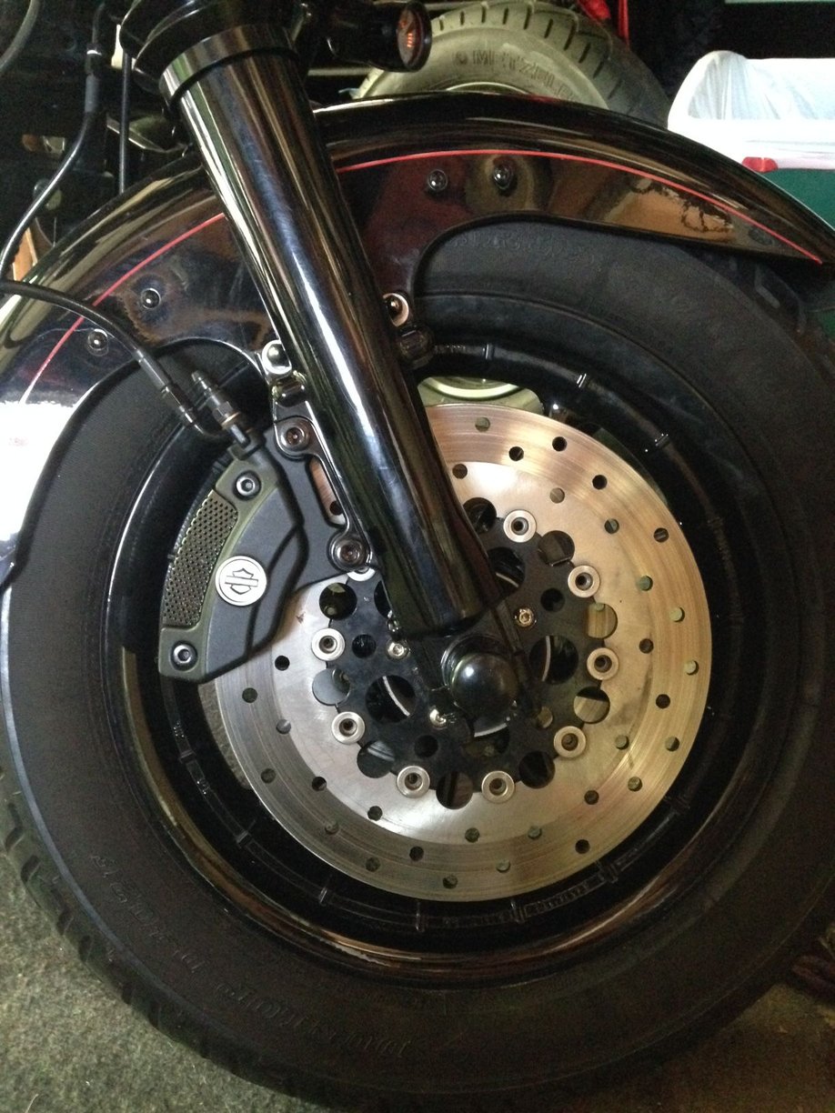

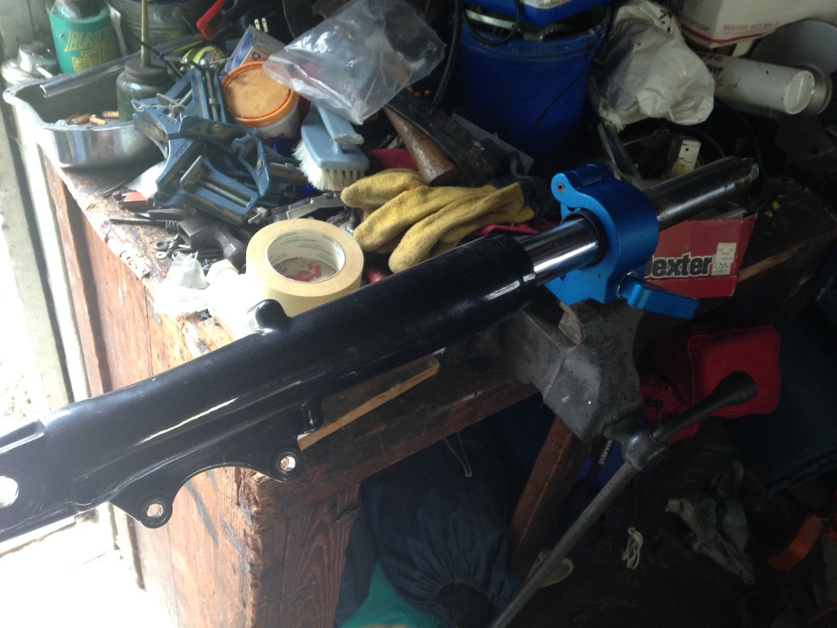

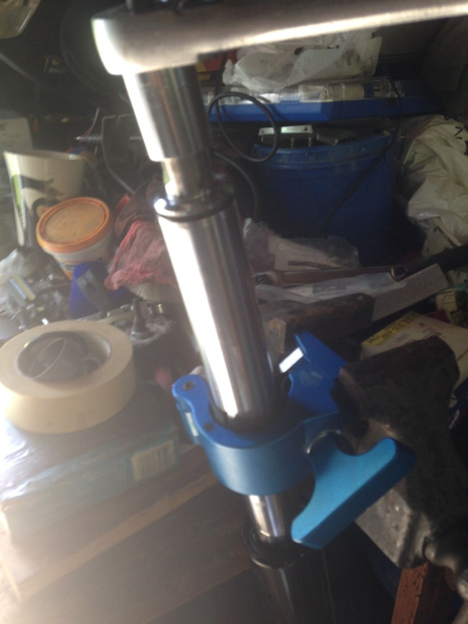

So, I'm done. I rebuilt the forks and reinstalled the Progressive springs and Intiminators. Having the Jims tool was a big help.

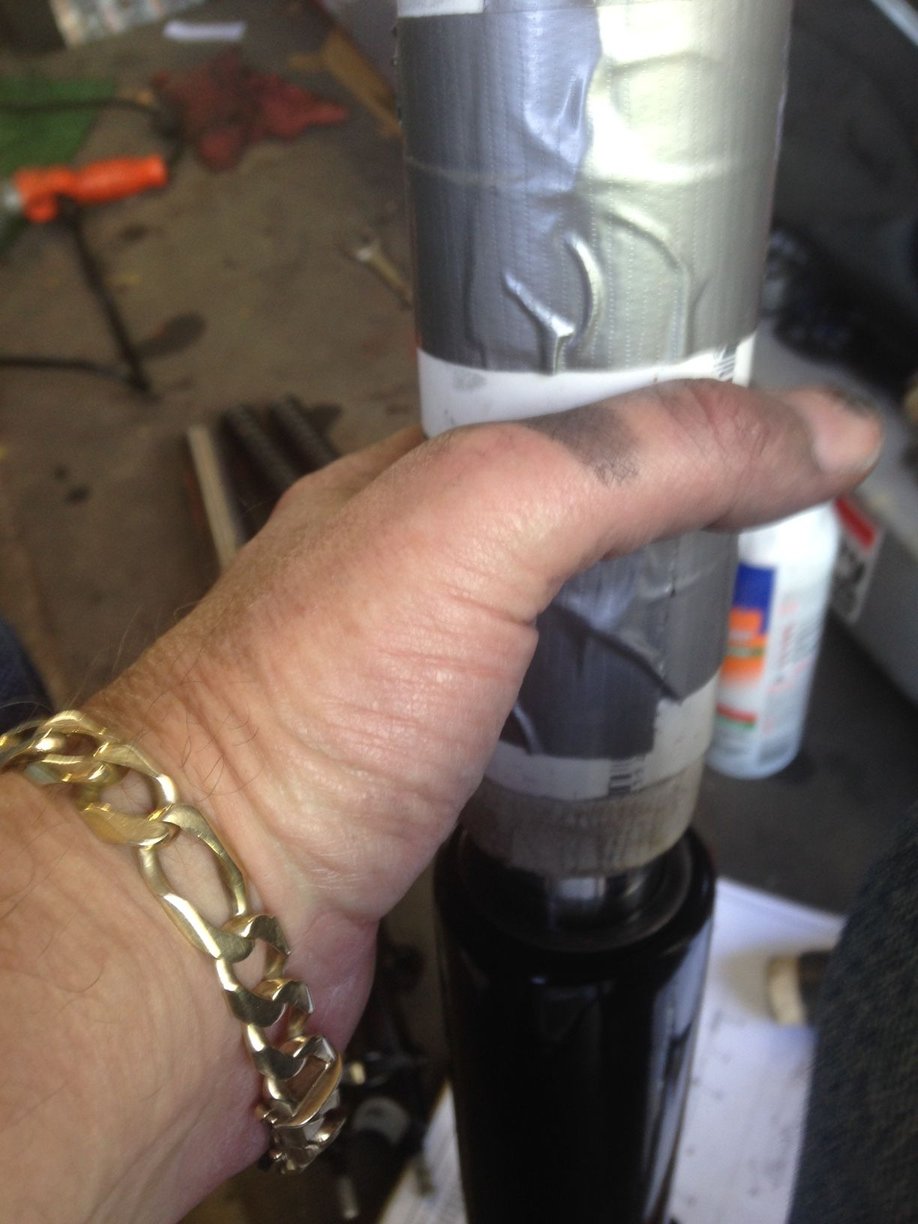

My trusty fork seal driver:

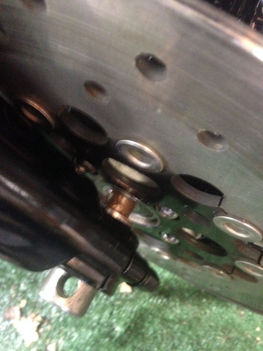

Forks reinstalled, Brembos bolted up, now the spacers. I had a variety of 3/4" spacers, none of which were any help. Cutting and grinding and I had what I needed. The left side was dialed in by grinding some off of the speedo drive.
All buttoned up:
I got to ride and enjoy the improvement for a week, then...............
I now have a pacemaker, and cannot ride until the end of the month. I have missed two planned trips guldernit.
Here's a list of things:
Brembo calipers
Semimetallic pads
Two black braided brake lines
2004 front "wagon wheel", powder coated
Two 3/4" sealed wheel bearings
1" axle, turned down to 3/4"
Two CVO 11.8" floating rotors
Fork rebuild kit
5 wt fork oil
2004 sliders, powder coated
I reused my front master cylinder.
I have my own brake bleeding procedure, using most of the tips mentioned elsewhere. No sweat.
When I upgraded to the 2000-20007 calipers it was a major improvement. The Brembos are even better and will do a great job with the hack remounted.
I want to thank those of you who contributed tips and suggestions as well as those who pioneered this mod.

It firmly holds the fork tube for disassembly and assembly. I've got three more to do this summer and the tool is a time saver as well as lessening the aggravation factor.
