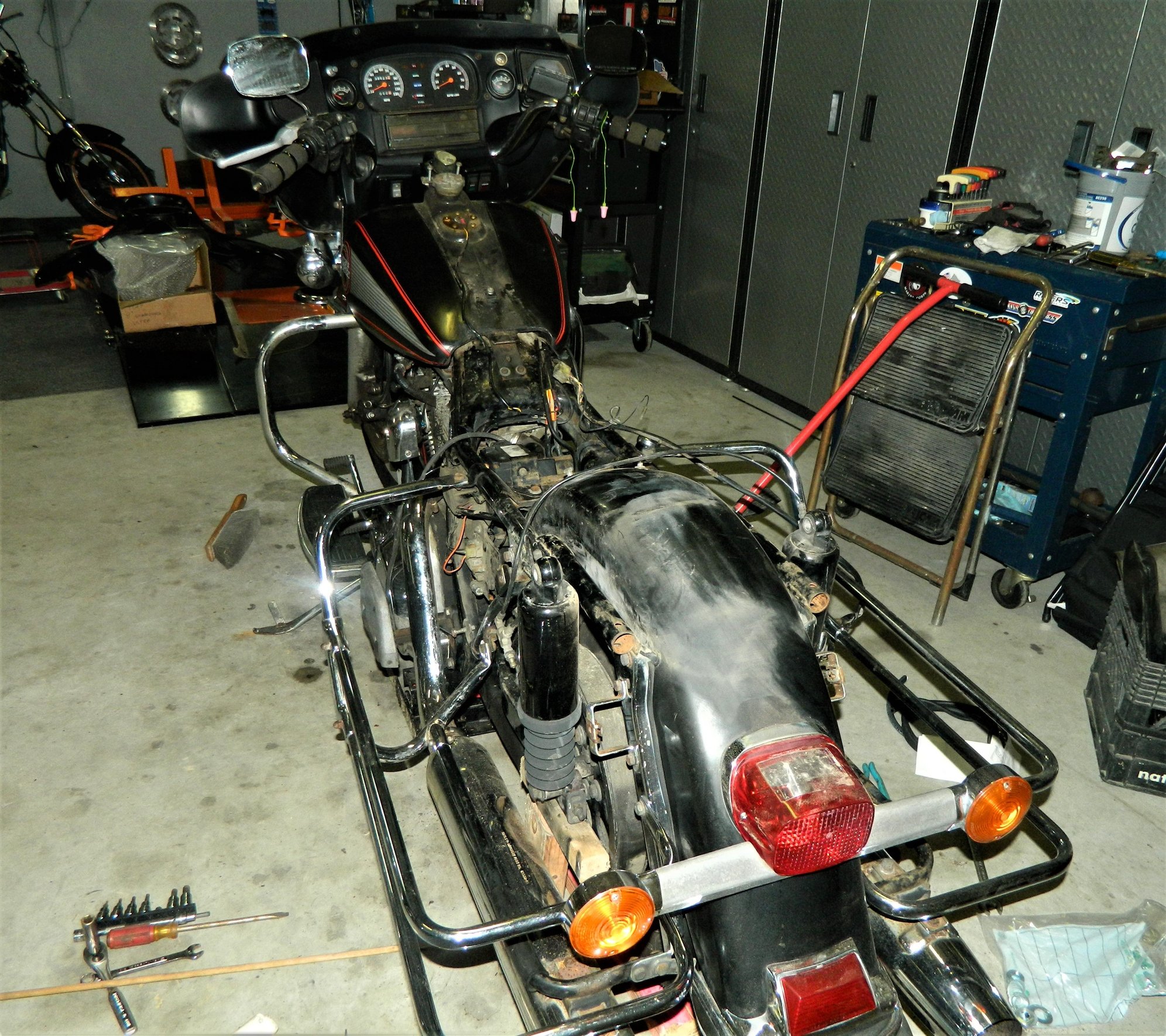

Here an update. Just cleaning, degreasing, and shedding the unwanted.
