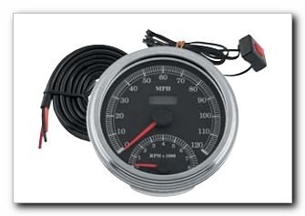

Damn this thing. I typed a bunch of stuff and it disappeared. I am looking at Biker's Choice cable driven speedometer / tachometer combo 48-2925.
Cable driven electronic controlled black faced speedo with digital odometer and 2 trip meters
Comes pre-wired with a push button switch to select trip 1, trip 2 or odometer and is programmable for use with any ratio speedo drive
Installation instructions and an adapter nut for use with either 5/8" or 16mm speedo cable nut
4-1/4" in diameter and a 4-3/4" top ring
Tach goes up to 8,000 RPM
Fits most 47-95 Fat Bob style dashes
I found it for $139
Is the quality decent? Will the tach quick working in fairly short order killing the engine in the process and leaving me stranded?

It arrived in the mail today. I opened the box tonight. It looks ten times better than I expected. The hook up looks fairly simple. The speedometer cable screws on like normal. There is a ground wire, a power wire, then a wire than goes to the negative of coil for the tachometer trigger. The only thing I don't like which is not a big deal I suppose is there is no way to set the odometer to the same as the original odometer reading. The units from Dakota Digital for example do have that capability. On the other hand, the Dakota Digital is a lot more expensive.
There is a simple program procedure for setup / calibration to go through.
It's made in Taiwan whereas the Dakota Digital is made in the USA.
What sold me on this was the OEM look and feel. I also like symmetry and this unit achieves that whereas most others don't.
Besides not being able to set the odometer, I have discovered that there is no provision for the self canceling turn signals. I can get that functionality by buying a badlands or similar module I guess, but I already have a badlands modules due to my LED's. Additionally that would put them on a timer instead working on distance.
So, those two things are a little disappointing and I didn't anticipate.
