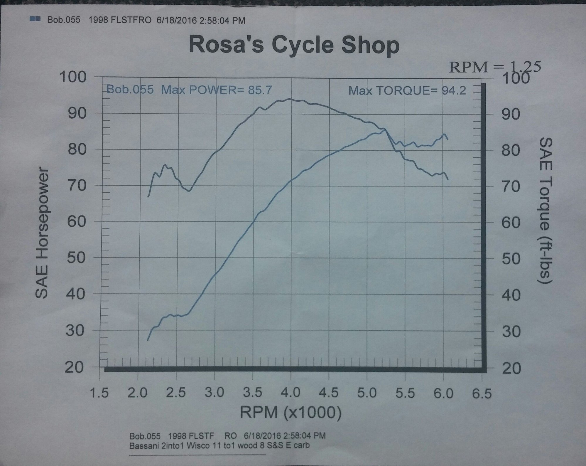

The way I understand it is that with black on black and red on green it should be infinite..... But when you swap the meter leads it should read under 1m ohm. On both of your readings your over 1m ohm.
I had a similar situation where my motor fell flat on it's face at 5200 rpm and the dyno sheet shows it... It appeared that my Dyna2ki ignition was failing at high rpm. I know that because i sent the ignition back to dyna and they're tests confirmed failure. Although it was out of warranty (2 years old) they still gave me a good deal on a new one... $153.00 shipped.... Hope this helps..
